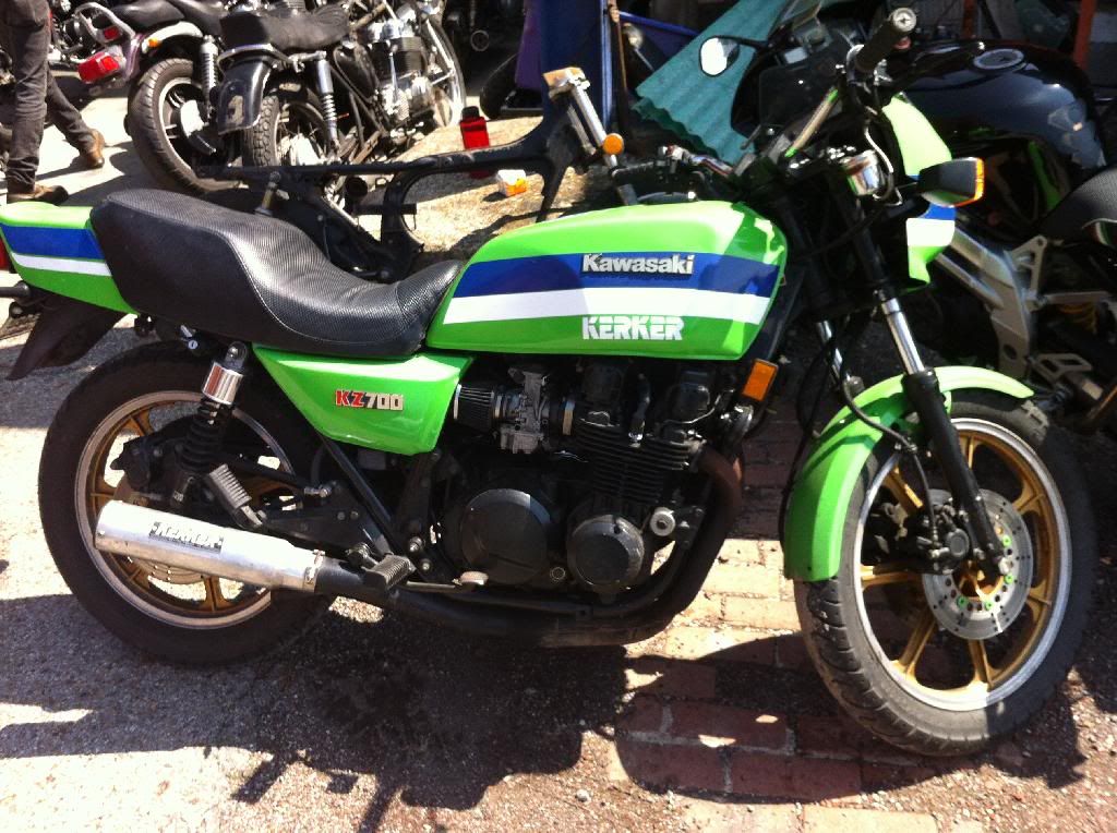

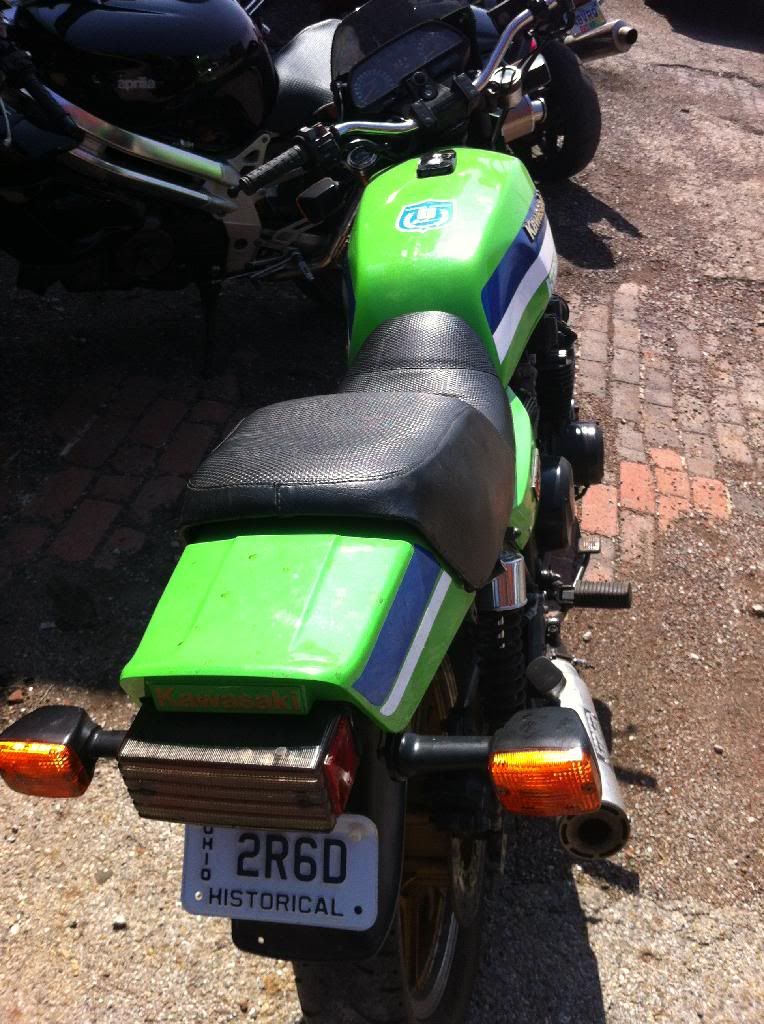

    can't add much to this thread but here's a GPZ700 (us only model) that someone dressed up as a 1 of none ELR 750/700. Saw this bike at Rice paddy a couple months back and thought it was cool. This is pretty much how I would do a gpz 750 since I hate red.
