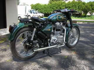

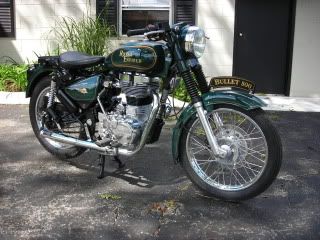

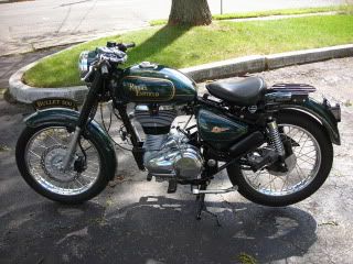

    My G-5. A work in process. But I think a handsome motorbike; fun to ride, and 70 MPG.
