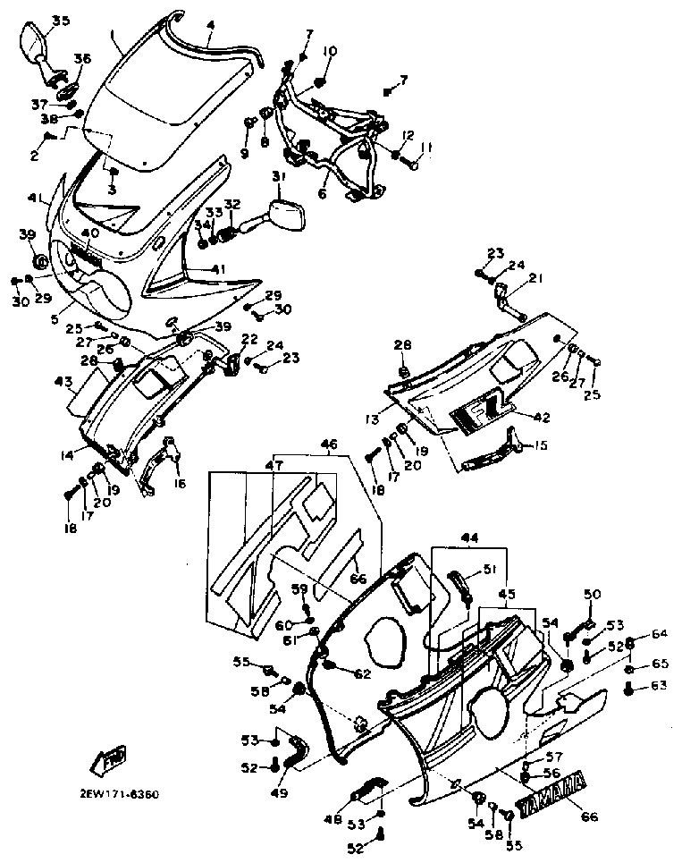

    I started on the lower fairings late last night (cuz that's quiet work and cuz I had resin a glass cloth sitting around) and today discovered the left side lower fairing mounting brackets are missing. Anyone got a lead on where I can find that kinda stuff, besides eBay? I can fab some up when I get to that point but there's nothing better than original if I can get them.

    The brackets I'm looking for are #48 & #50 in the pic above. If you have em I'll buy em. Thanks.
