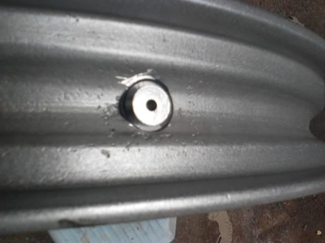

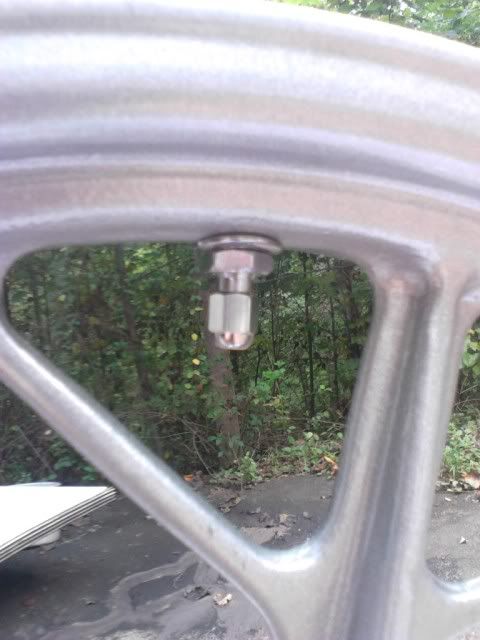

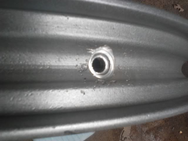

Ken, Is there difference between a tubeless tire and a tube tire in the bead? I think not and therefore how would the wheel notice any difference in the way the tube seals against the rim? I converted my Kimtabs from tube to tubeless. I had to machine a modification to the valve stem holes is all, but I do notice the bead not seating correctly so far. The modification was because the radius inside the skinny wheel was so small the bolt in valve stem wouldn't seat and seal properly and the hole was just big enough for the tire stem. I bored the hole and recessed it to fit the new stem.

That wheel you modified looks pretty porous, does it loose air or does the paint seal it?
