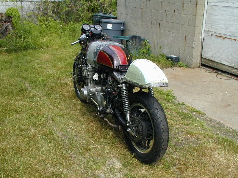

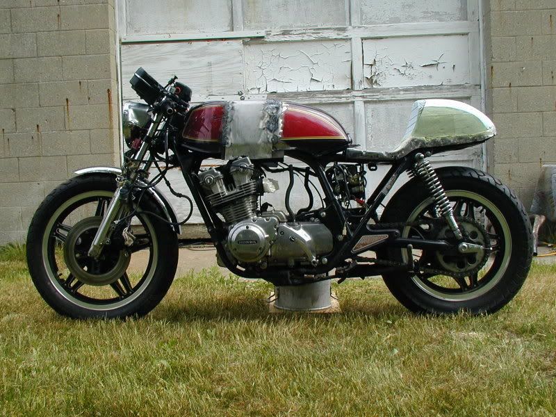

    My friend (catboy) is working on a '79 & it's starting to look pretty damn cool. Hasn't spent any real money yet, because his talented dad is doing a bit of the work. I'll post pics if he doesn't mind.
    post that shit!
    ...thousands might not be too off the mark depending on what you want to do, what needs to be done to do it, and whether or not you or someone you know can do a vast majority of it. wise men make good freinds of talented fabricators with lots-o-tools!

    catboy's '79 cb750 (in progress):
    If I'm not mistaken, he's spent money only on clip-ons so far, aside from normal maintenance items. Much less than $300,eh? And $10 for an eBay spoke wheel. Save your comments about the tank. His dad, whose doing that part, is a magician. I've seen other stuff he's done.

    I figured the tank was a placeholder for sizing, myself...I think the bike is going to be pretty cool...
