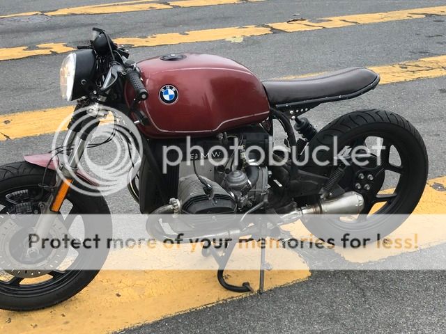

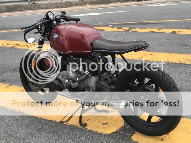

    Nope, that one sits much lower, plus you can see the ends of it. dude that one looks sketchy as hell because it lacks the uprights that run from the peg brackets to the middle of the subframe to support rider weight. I wouldn't ride that. It looks homemade or like someone bought a generic seat hoop off ebay and welded on some mounting tabs. Seriously, that literally scares the shit out of me as I don't think those stock forward subframe brackets were meant to take a 200lb+ shearing load. Maybe ze germans built in enough of a safety margin but I wouldn't bet my life on it by riding it.
    Also no rear fender and no provision for a rear fender mount. Pitch that garbage in the trash. I thought we discussed this.
    Quote Originally Posted by imtheant View Post
    This seat looks razor thin so that's going to be the first thing to replace.
    yeah he probably bought the hoop as seat pan as a set and then stretched some boat vinyl over it. I'm telling you - throw the whole back end away and start over.
    So the good news is that you wanted a project and you sure bought one. I think you have some good bones there, but there are a lot of red flags. Let's address some of them.
    - No stock gauges. So here is a fun fact, the generator light on the instrument panel is essential for the bike to charge. Don't ask me why, I didn't design it - but those kooks in bmw engineering routed the circuit through that light so when it isn't there or blow out the bike doesn't charge (fun fact the generator light should be on at idle and go out as revs climb). The bike also won't charge if another light of different amp draw is put in it's place, like the one say as part of the aftermarket gauge. I am not saying this was done correctly or incorrectly since I haven't seen the bike, but it is my 100% recomendation that you put a multimeter on the battery while the bike is running to see if it is charging at all. you should see a draw at idle (under 13.8) and 15.8V at redline. I would also inspect how that gauge is wired in because if it is home depot crimp connectors and electrical tape - you have your work cut out for you.
    - no signals. So my bike didn't come with signals either and it has been a fun adventure wiring them in because of how the bmw is wired in general. Actually, this is the one part of the bike that is most like a car, and it's a simple circuit, it even uses a flasher solenoid for an 80's saab and 2000's toyotas. I got lucky and my PO had tucked the wires away instead of clipping or cutting them. Still, it has been an adventure converting to LEDs, esp with how well insulated and shielded everything is from the factory. you can't just throw an LED compatible flasher in the system and call it a day, and it all ties into the idiot light panel on the stock gauges as well - so that will be fun if it's been monkeyed with.
    - The wiring in general: that trascan worthy headlight and the way way way too small taillight give me pause to think that the entire electrical system on this bike has been monkey'ed with. there is a reason why snowbum on his site has an entire tolken like saga about the correct bulbs and the ones that could be used as a replacement when the 100% correct ones are not available. Care has to be taken when building a custom and I'm seeing way way way too many cheap ebay parts to think that it happened. Not that I am against ebay parts mind you, but in moderation, for certain things.
    - Exhaust: the good news is that the PO left everything from the stock headpipes to the cat and only removed the rust prone and heavy stock mufflers. The bad news is that I am not seeing how those new silencers are attached to the frame, and the stock system without the silencers is too heavy to be held up by the headpipes. I would inspect that system for cracking (probably hasn't happened yet) and then find a way to attach those cheapie twee mufflers to the peg mount they seem to be jammed up against. If they are attached, then carry on.
    - Fork gaiters: WTF?!?!. Aside from being useless, they look like they are hiding rust. Also your fork slider dust covers are missing.
    - Front Brake lines: Those aftermarket ones look sketch as hell. I wouldn't trust that they don't rub the tire at some point. The stock setup uses a hardline crossover (which bmw still makes) that runs inside the stock fender. It does a good job and keep thinks clear of spinning bits and bobs. The good news is that the front fender looks like a stock one that has been cut down and you could probably convert back to the stock setup.
    The airbox and 90% of the exhaust doesn't look touched so that is probably a good sign that the engine hasn't been messed with by whomever committed this war crime of customization on that bike, so if it was maintained it probably runs well. Don't trash the airbox and run those twee pod filters unless you are planning to replace those CV carbs with flatsides. your intake is not restricted, it is well designed by BMW engineers, and everybody who monkeys with it for a look without putting in a big bore kit, better carbs, etc...typically loses power and also ride-ability in the midrange. You have a nice aftermarket sidestand (fun fact, R series monolevers didn't come with side stands, and I like yours better than the one I have), your rear drive doesn't seem to be leaking anywhere, and you have the dual disc setup. the stock bar controls are still there, the hard to find stock tank is still there (yes that tank is very difficult to find even though it is the same shape as the 1977-1984 tank - the tunnel is different to clear the electrics on the - 85-95 bikes).
    So what would I do if I were you (ie. some fun projects that I feel just make the bike better)?
    - Start with the front end and service the whole thing. Check the dates on the tires, they look new but you can never be too careful. Since those wheels look powdercoated, hopefully new wheel bearings were installed and properly greased. Take the forks apart, clean out the sliders, and put in new fluid and seals. It's cheap insurance and a fun project. Plus you can remove the reflectors and polish or paint the lower fork legs while you are there.
    - check the steering head bearings to make sure they are in good shape. if not replace.
    - give the bike a full fluid and filter service. Pay very careful attention to the $2000 o-ring in the oil filter cover (called that because if you install it properly you oil seize your engine). Check the valve lash settings.
    - check the front brakes for dragging, rebuild the calipers if you must. Figure out that line setup. I run the stock hard line crossover with a single braided line up to the master - much cleaner.
    - As someone who spent an entire summer filling his bmw tank through the petcock hole, replace that key'ed fuel cap. they are a common failure item and when they break they lock you out and have to be drilled to be opened. I replaced my broken one with this:
    https://www.ebay.com/itm/Petrol-Cap-...72.m2749.l2649
    - Figure out that rear. I've given you some suggestions on a good subframe, but there are other makers like Von Zeti, ritmeo sereno, Flatracer, wimoto. All of these are legit companies that make a product that works and have customers that attest to their quality. Flatracer makes a way better rear fender setup than D&O but they don't make a subframe for the monolever (they do make a lot of parts that work with the stock subframe). I just don't trust that setup you have now man.
