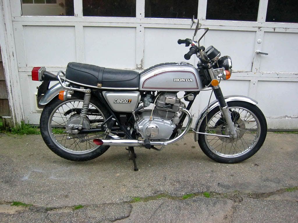

    Senior Member champ's Avatar
    Apr 2007
    , New Hampshire, Monaco.
    2,843
    JS
    Member inline4's Avatar
    Jan 2008
    Memphis Area, Tennessee, USA.
    45
    champ!!!
    Man that is one beautiful 200T!!!!!!!!!!
    That pic alone has made me have a change of heart as to how far I want to take the rebuild. JFC!
    Thanks for your input.
    To be honest with you, I actually plan on selling the T as soon as I get her presentable. I just figured the small cosmetic upgrades would offer a bit higher resale value (unless the potential buyer was a purist).
    Care to elaborate on that exhaust system?
    Kudos my friend. Kudos!
