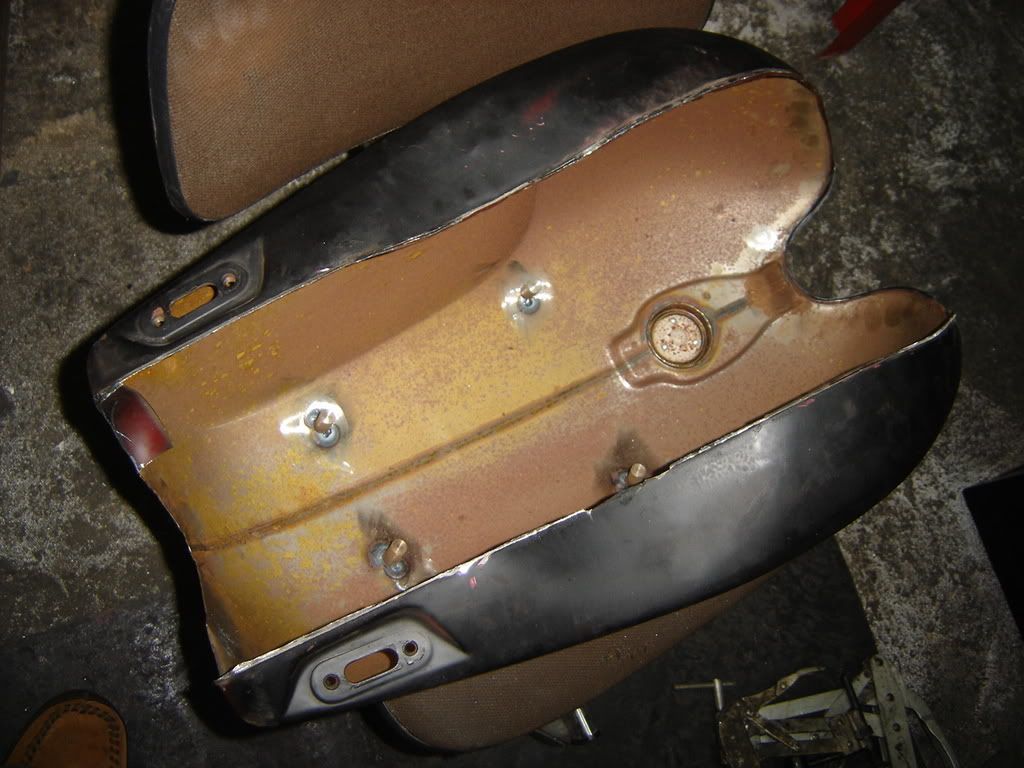

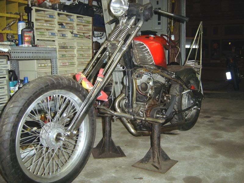

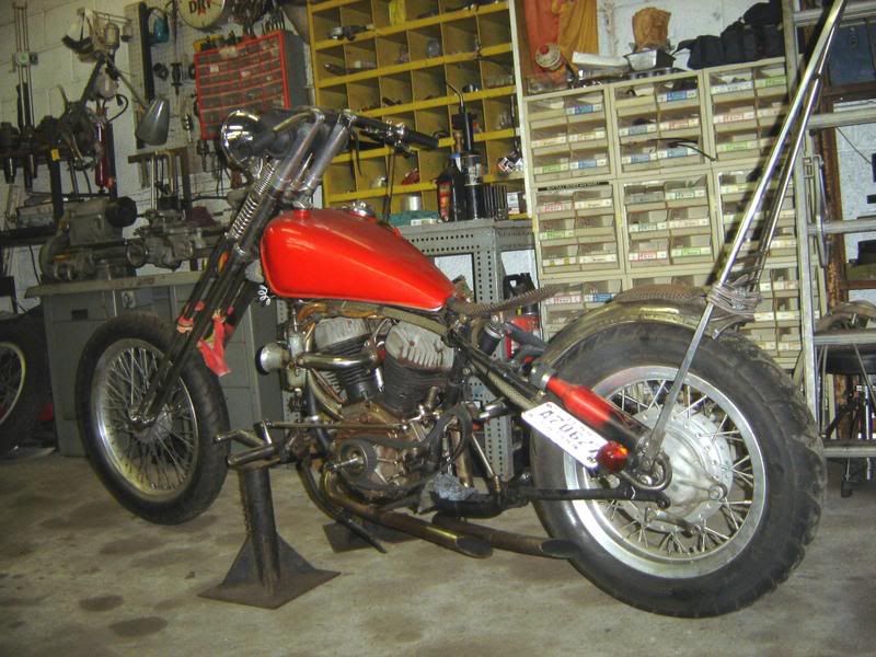

    I'll post up a few pix of some rather unusual tank things I've done but for starters
    here is a tank that got a Brit parcel rack, and then a new bottom with tunnel so it would be tailor fitted to a bike it was never intendd to fit
    another one
    this compartmentalized tank holds both oil and fuel, the oil portion has a replaceable filtered return whose return line flow is visible from the seat
    I started with a tank which I used only a section of the two outer shells
    everything else was fabbed using polished stainless
    so if you like metal arts and crafts and can make metal stick together
    you can make many things happen even if you don't own an English wheel and planishing hammer
    good luck

    Hack, that chopper is awesome.

    Thanks, closest thing to an offspring I have although a couple of my fbed bikes are wanting to be written in the will. I blew up the tranny last year when I broke 100 mph on it and was very proud to have done it.
