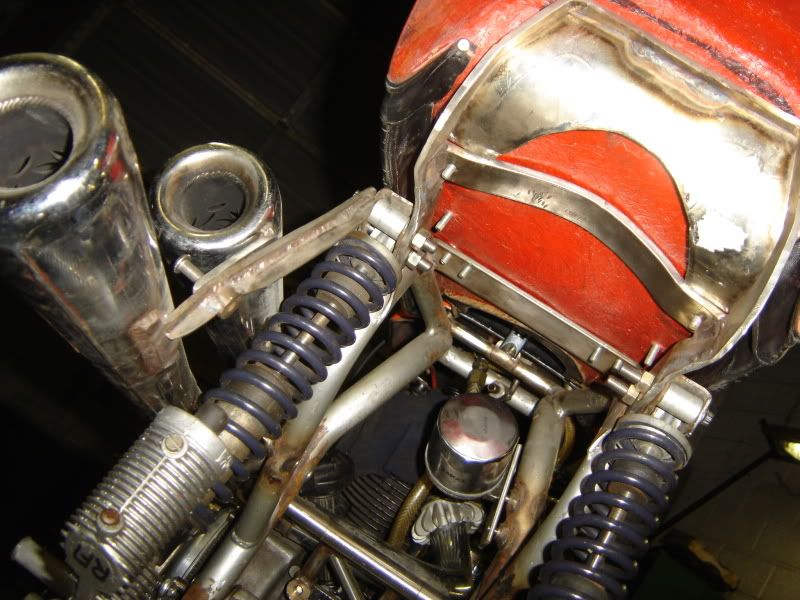

    it's quite common for all but the best aftermarket exhaust systems to have thin and frail tabs and even to see them incorrectly joined to the tubing
    so it doesn't surprise me that yours broke solidly mounted
    MAC has made some good exhausts but some of the are not very robust in my opinion
    if you really want to see some laughable attempts at mounting exhausts systems solidly
    study any of the vintage brit bikes, the triples are generally ok but most everything else is silly frail and cheaply done
    but, that doesn't mean that solidly mounted exhausts cannot be done right
    the pipes on my red 45/750 are mounted solidly enough to hoist the bike by them and they only have a slide in slip fit into the ports
    they are stainless and 5 years still going strong with no sign anywhere of problems
    are not the stock systems on these bikes solidly mounted?
    I am pretty sure they are and I'm equally sure I've seen more than I can count that sported original exhausts for 10,000 miles or more
    did your failed MAC system have any mounts on it that remotely resembled this kinda stuff? that's just the rear one too
    those pipes aren't going anywhere and I'd be shocked if any part of the exhaust system failed
    reckon that's just fanatical overkill?
