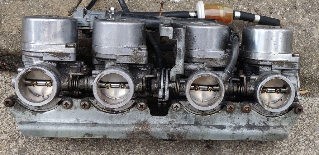

    I finally balanced the carbs. I bought the gauges from Alpha Moto and they have really nice adjustable dampeners so that the needle doesn't jump around.
    I got it fairly spot on, maybe the 4th cylinder is not perfect but I am really happy with myself especially when I didn't have a proper tool to turn the lock nut without also turning the balancing screw at the same time.

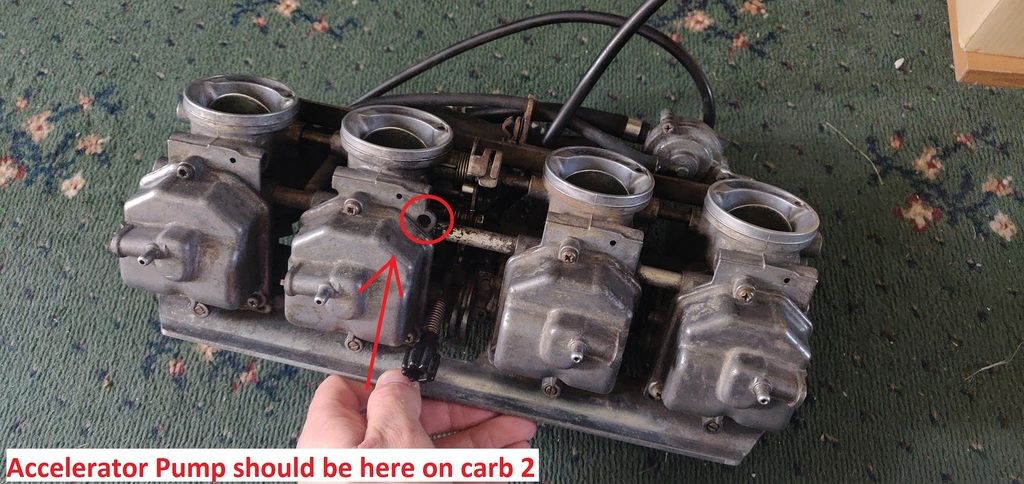

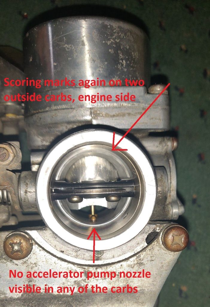

    #2 carburetor probably has some kind of fuel pump thingy on it yes? That could be an accelerator pump or it could be a decelerator fuel pump. You might want to research that part because it seems to me they added a decelerator pump to some motors to deal with over-lean operating conditions when the throttle is chopped.
    You have to remember that on a CV carb your throttle cable controls a butterfly valve but that valve precedes the vacuum operated slide valve. By design there is a lag time between the operation of the butterfly valve and response to open the slide valve. On closing the throttle both valves slam shut very effectively, fuel circuits were added to the design of later CV carbs to accommodate that operating condition, your carbs could have as many as 5 fuel circuits to control air and fuel ratios throughout normal operating conditions, blockage in any of those tiny passages is a common problem.

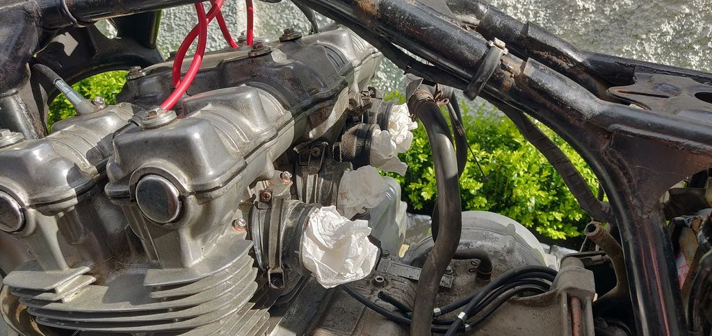

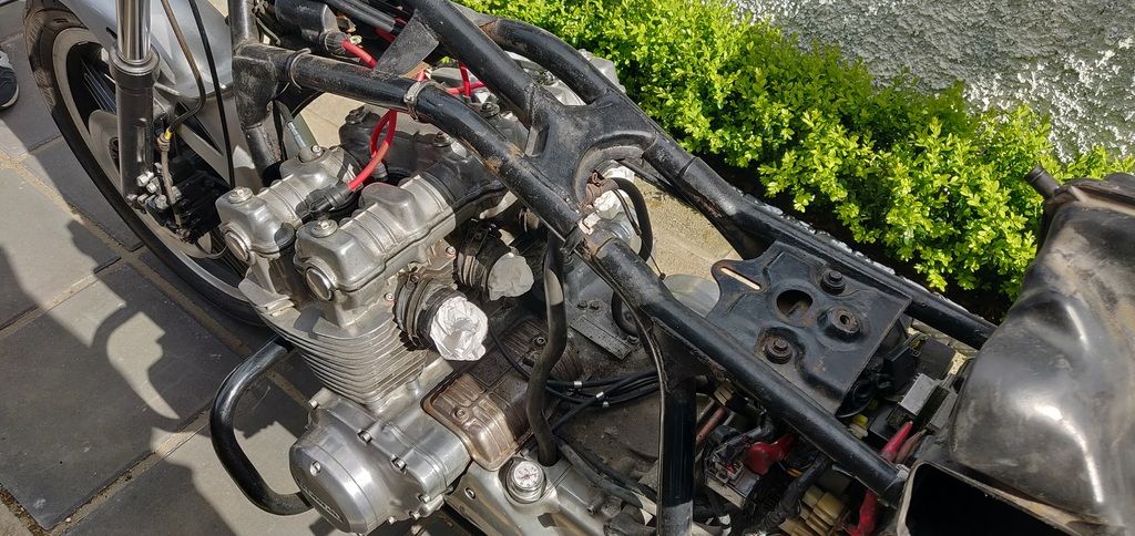

    Shortly after balancing the carbs I noticed that the throttle is sticking open, so I replaced the push pull throttle cables with new ones.
    One of the old ones had a kink in it and it was causing the problem. I lubed the new cables nicely put some grease on the bars underneath the throttle tube.
    I also got a new tachometer cable just because.
    It was a very noticeable improvement, throttle was very smooth, and after adjusting the idle speed slightly I could take the bike off choke in about 20 seconds so that was great.

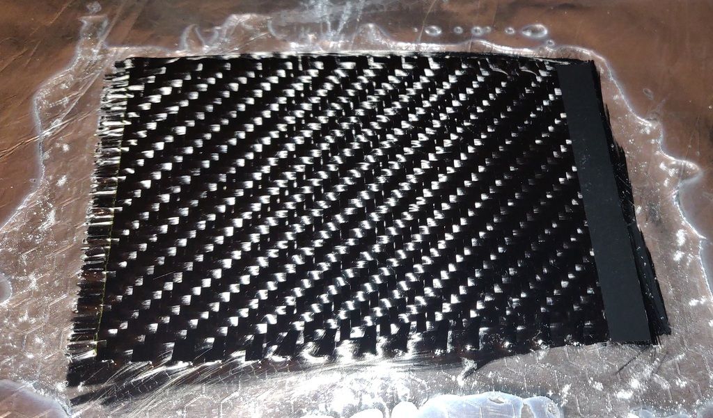

    I started playing with carbon fibre and epoxy resin, just out of curiosity of how you work with this stuff. It comes out really nice and i might do something cool for the bike soon.
    I'm also slowly buying/preparing equipment to repaint the bike.
    I plan to go for deep metallic black with a red stripe running down the middle.
    There will be a chrome-looking Honda sticker with the wings on the tank, and a red CB750F on the side cover.
    The side cover stickers I got are reflective stickers, i don't know if its a good or a bad thing yet, but i like them.
    I did a mock up on the computer just to see how it would look in black (just inverted colors) and I am happy with it.
    So I was really happy, bike running best I ever saw it run, just the paint job and the project is complete, but then disaster struck!

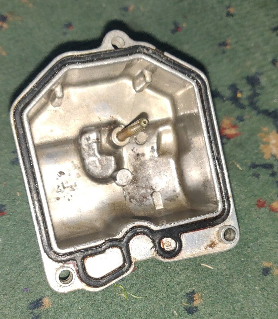

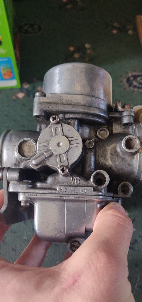

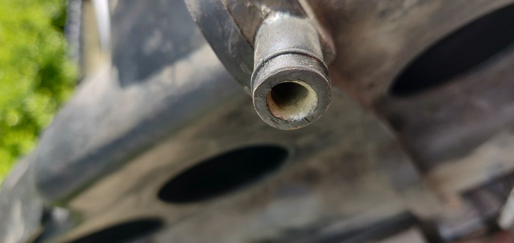

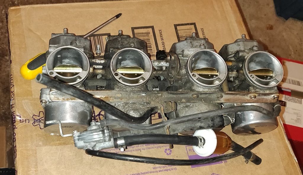

    I fired the bike up and noticed that fuel is pissing out of one of the overflow tubes at the carbs. Small tear-down to take out the bank of carbs with the airbox.
    I also noticed that the fitting at the top of the airbox which is the input of the crankcase ventilation system has this yellow goo on it. What could that mean?
    I took off the float bowls, and saw that they are really quite clean on the inside. No fuel turned into varnish anyway!
    With the carbs and float bowls off, I poured some fuel into the input tube, and tested the float valves individually, by keeping 3 closed and opening one at a time by hand.
    None of them was leaking! So I'm not sure what was going on (maybe one stuck open). I guess it works as expected and it would be fine now if i threw it back on the bike.
    One other thing I'm going to check though is maybe one of the overflow tubes that stick up in the bowl is cracked along the sides or at the bottom. If that's the case then the fuel doesn't have to reach the top of the tube to go into overflow.
    And because its taken off now I thought I might as well take some time and clean it up a bit later. Any tips on this?

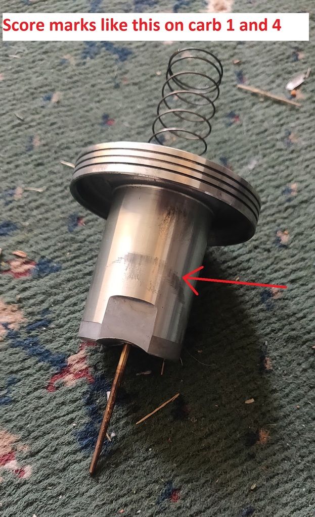

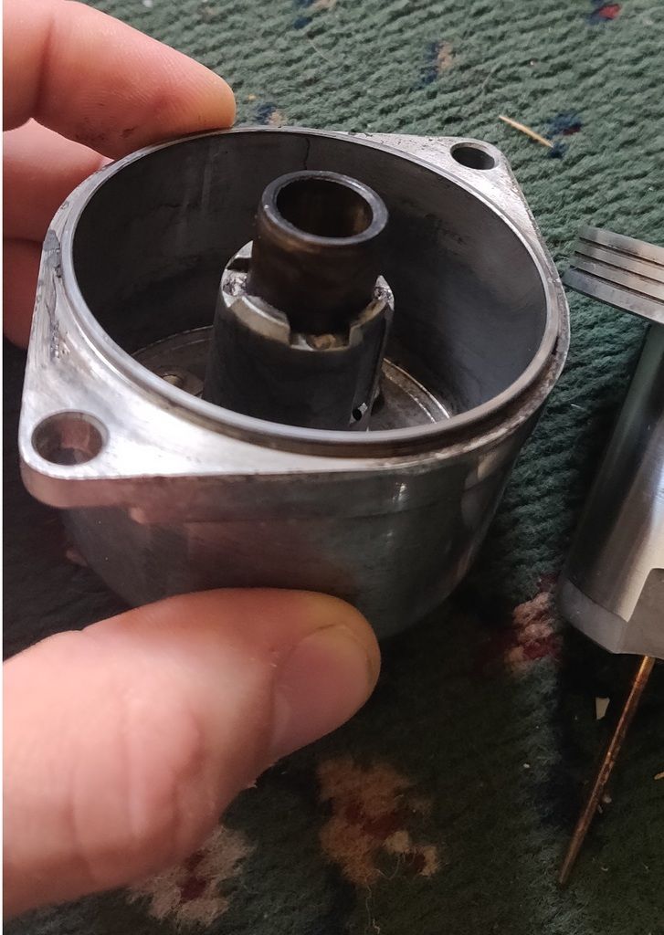

    I was quite surprised to see that there is no diaphragm underneath the top caps of the carbs. Instead, they use a metal puck and very tight tolerance to make a seal and work in the same way as a diaphragm (vacuum created on intake pulls the puck with the needle up etc).
    I have a couple of questions:
    1. Should I use some lubricant between the puck top ring and the inside of the top cap to make a better seal? Maybe polish the two surfaces?
    2. Should I also use some lubricant on the slides that go up and down inside the throats? There seems to be a lot of rubbing action there, and the slides of carbs 1 and 4 have visible scoring marks on engine side. 2 and 3 are very smooth

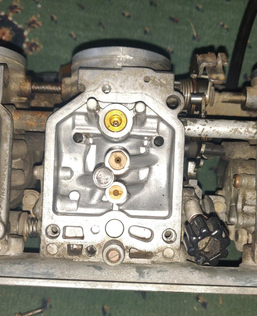

    3. Could someone explain what's the function of the air cut-off diaphragm? there is one on each carb.
    4. I totally don't have an accelerator pump on the #2 carb. I also cant see an accelerator nozzle anywhere in the throat of the carb. I thought these bikes came with one. Is this normal?
