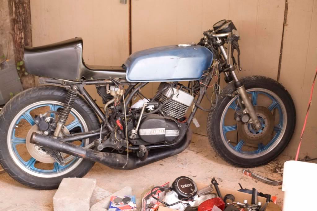

    This is how it started, I picked it up for $300
    This week I started realy working on it
    I'll post up more soon

    Not bad for $300.00,has pipes,FG seat,mags,f&R discs etc. You could part it out for more than that and still make a little cash! If the frame,tank<tires etc. are good and you got a title that's great. Make sure the crank seals are good.

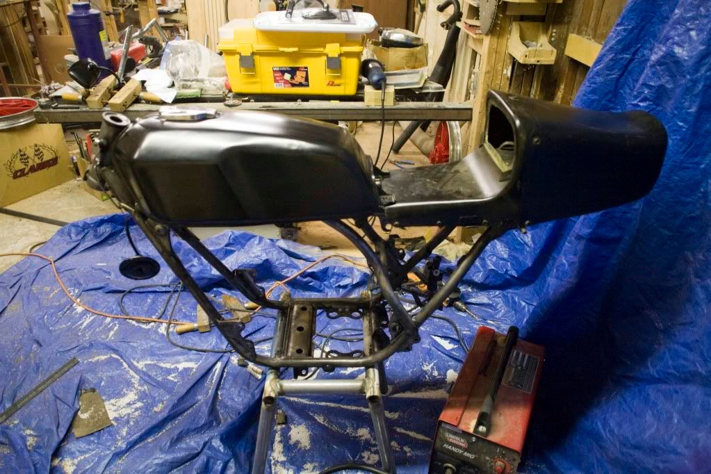

    Today I made some mounts that will work with the rear sets that came with the bike
    I started by swinging the rear set up and drilling a pilot hole.
    After that I enlarged it to 5/8 to except the stud I was about to mill.
    I then went to my mill/lathe and turned the studs
    Tapping the stud
    Finished studs
    Welding them in
    I did a lot better with the bottom one than the top, may be because I was trying to time it with the cameras self timer any how I'll clean it up later when the bike is down to just the frame
    Trying to take the photo and weld I stuck the welding tip in the new threads so I re tapped it
    I think that this should be stronger than it was.
