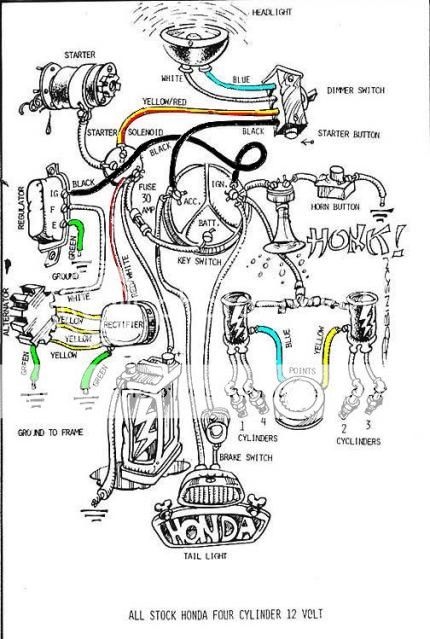

    i know its a four cylinder but just convert it to 2 this will run any honda
