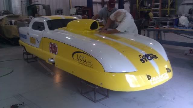

    Your method was the same time saving method Bob used when making the nose on the Bonneville car we built. When asked how he designed the nose he said "I glued 3 big blocks of foam together, drew the shape of the firewall on one end, got out the chainsaw and cut off anything that didn't look like it would go 300mph."
