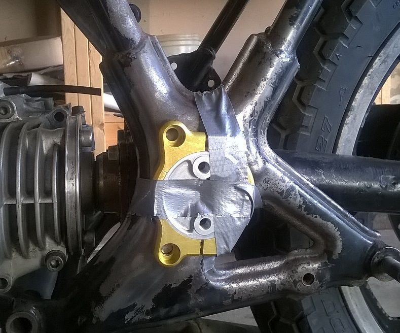

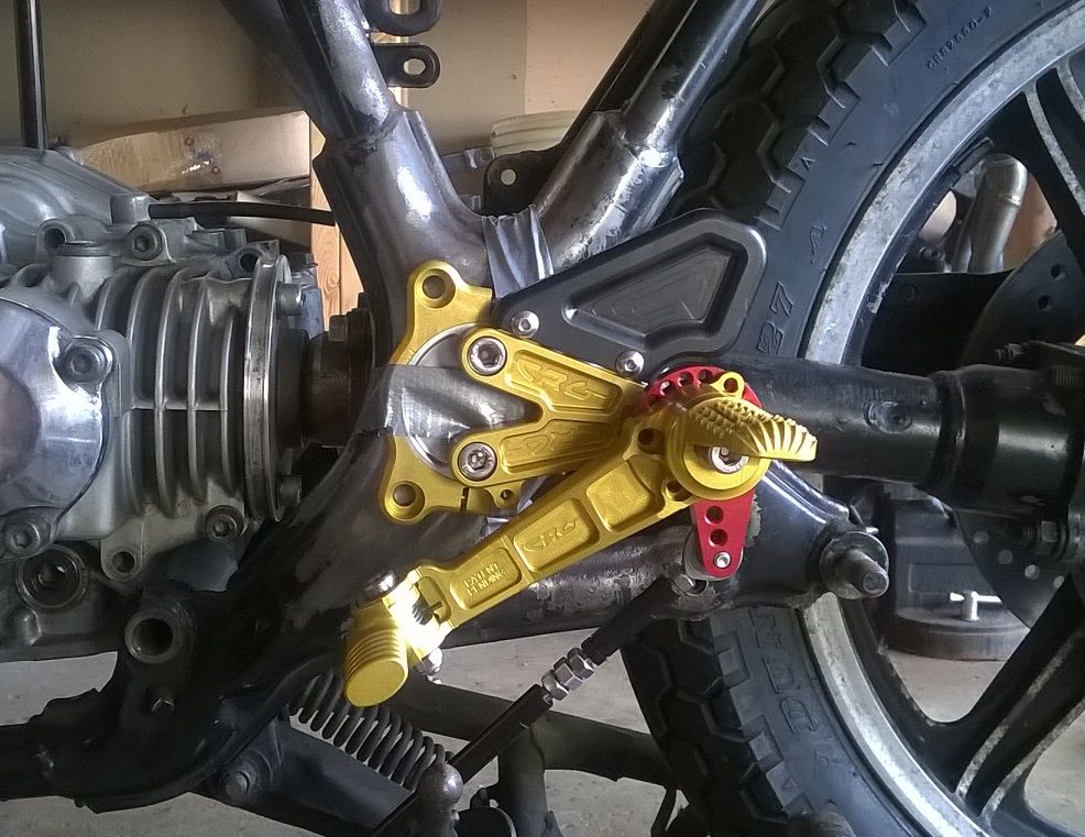

    Here are the rearsets. Not the color I wanted but I found them on close out and really liked how they mounted and the adjustability.
    This is the mounting plate.
    Then the rearset.
    As you can see, the xs750 uses a stamped steel section for the swingarm pivots. Not the strongest of structures.
    I'm weighing the risks and benefits of drilling in that and welding a couple 3/4" steel bungs tapped for the mounting tabs bolts for the plate in the first pic.
    thoughts?
