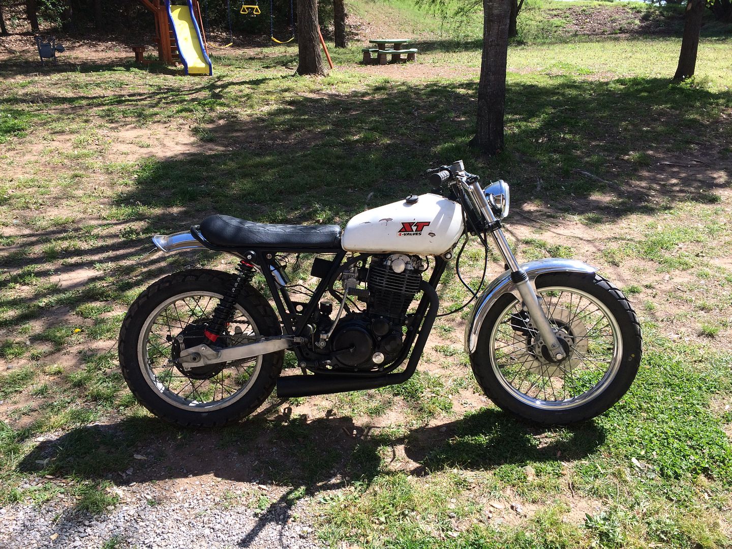

    The titty gots some new shoes. Still waiting on the caliper banjo bolt. Got the rear brake switch functional, just need to finish wiring. Clutch cable won't work with the aftermarket perch, so I need to track down the OG one until I can get a fancy cable made. Was really hoping to run it around the block today, but it shall wait. I've got all the vm34 Mikuni stuff ready to order, totaling about $117 including all the necessary jets to get me close enough.

    I finally broke down and bought a Mikuni VM34. The stock carb was bananas from the get go, and getting a good reliable start cold was somewhere in the 4-5 kick range.
    I decided to copy some average jetting data that has been posted with the 34 in hopes I could start out in a decent spot, so I went with the following:
    main 230
    pilot 27.5
    needle jet p6
    needle 6dh3 on the 3rd clip
    Started up and idled on first kick.
    Probably could still use some tuning, but I need to address the dragging clutch first as well as wiring up lights. Also need to get a Uni filter that will fit the mouth of this carb as this one is slightly larger than the factory.
    Also got the front brake bled, so I can stop now too.
    drgonzo likes this.

    After a week chasing my tail, the clutch issue has been resolved with an NOS push rod. It was exciting to feel it finally allow me control of the clutch, so I started piecing together the throttle cable elbow for the vm34, and putting on the new UNI filter that has the properly sized opening. I kicked it to life, and took my first "real" test rides around the neighborhood.
    First few impressions:
    This thing feels so light and nimble. Definitely a plus.
    Shocks feel a little stiffer, but I think it suits my riding style.
    A little more ticking from the exhaust valves than expected. May have to do the grub screw mod.
    From mid to full throttle the bike loads up and falls flat on it's face. Lots of popping on decel. I was thinking the main jet may be a tad rich, but I noticed a slight puff of air coming from the exhaust I made up. It was a factory drain hole in the kz440 muffler back when it was still double wall. I think this clearly isn't helping the popping, so it's first on the list before moving on to any other possible air leaks. The stock intake rubber is original, and the vm34 sits a little looser than expected until it's cinched down. I may find a new intake boot that suits the vm a little better, but for now just want to confirm it's sealing up tight.
    Plug color is a lighter coffee more towards the rich side of the spectrum but that could be from the idle circuit. The electrode strap shows no major heat past mid strap, so I don't think I'm going lean anywhere.
    I'm going to re-check timing with a gun and adjust accordingly.
    Lights still need wired, but that shouldn't take much effort.
    I think my master cylinder may be a hair on the small side. It's 11mm and I think 12 or possibly 13mm would give me a little firmer feel. After a few hundred test miles I should know whether it's going to need changed for sure though.
