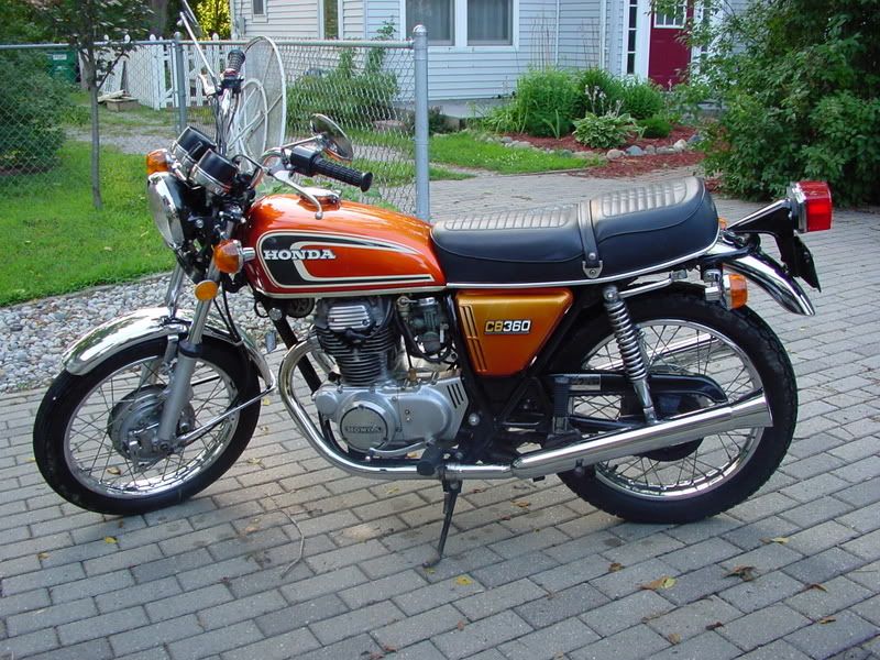

    Nice job. I like your seat. Getting ready to try my hand at fiberglass, and do a seat for my cb350.
    Cb360 is a fun bike. Overshadowed by the cb350. Here's mine:
