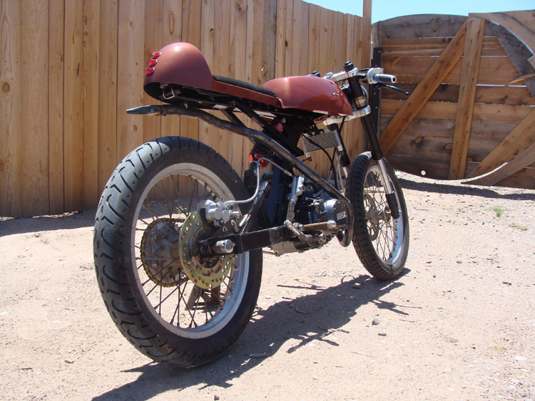

    from an email I get from the kat who built it:
    The front and rear
    rims are from dirt bikes. The front forks, rear shock, front and rear
    brakes, and motor are all pitbike stuff off ebay. The motor is a GPX
    from pitsterpro.com.
    I've got a couple S90s and a lifan 150cc, I think there's a yz80 dead out back for hubs and brakes, the pitbike parts are easy to get. The forks I've been looking at locally are 40mm USD, externally adjustable comp/rebound damping etc etc and come complete with really clean milled aluminum triples that will take the S90 stem easily. They're $200.

    So wait....are those pitbike forks on that bike????
