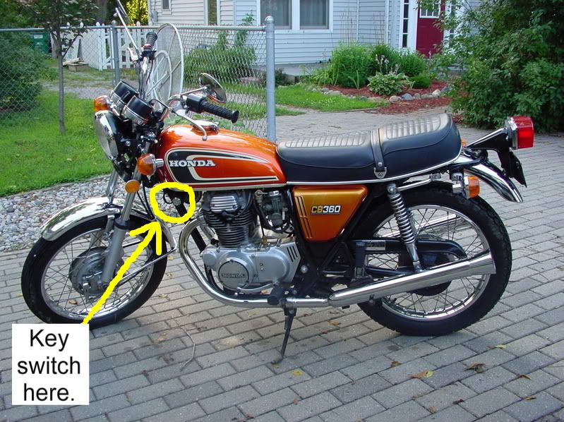

    The previous owner of my CB360 lost the key and replaced the ignition switch with a battery cut off switch mounted to the handlebars. I have purchased a replacement ignition switch but I don't know where it mounts! I have looked on the left side of the frame, just under the tank and can't find anyplace obvious. It also doesn't appear to mount as part of the guage cluster.
    I have searched the internet trying to find a picture that would show the location but can't find one.
    Could someone tell me where it is mounted? Better yet, could someone post a picture showing where the ignition switch is located?
    Many thanks,
    Stephen

    Not the best picture. Switch mounts in a bracket, which I think attaches to frame at coil bracket. It's pretty self explanatory once you remove the tank & take a look at the parts. I think I have an extra bracket hanging around somewhere if you need it.
