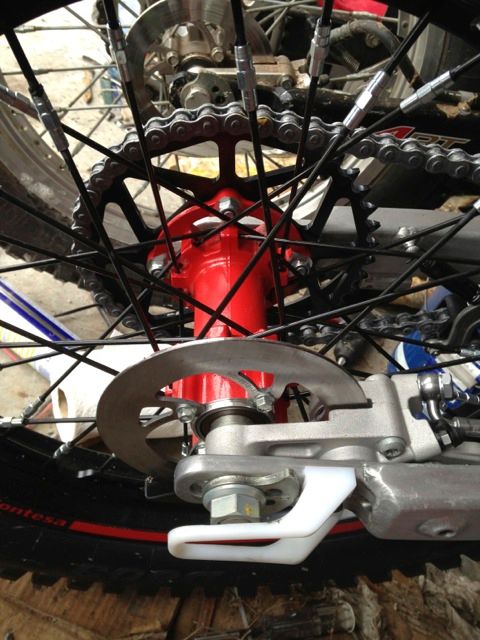

    Only on the rear of Trials bikes :I
    One big advantage is that you can dispose of rim locks, which are both weighty and troublesome.
    Variations on the tubeless rim design have evolved away from through holes, because they require a big fat rubber seal over the spoke nipples, which is both weighty and troublesome.

    There are, of course, tubeless-type wire-spoke rims. The majority of the aftermarket ones are mainly for choppers, and have some super-exotic spoke setups. But the OEM ones have a tall center flange, which the spokes hook through, and nipples located the hub. The three I bikes I know of that come (came) with this type of setup are the Honda CMX450C Rebel, the V-Strom 650 (I think just the XT adventure version?), and the Yamaha 225 Serow (back wheel only).
