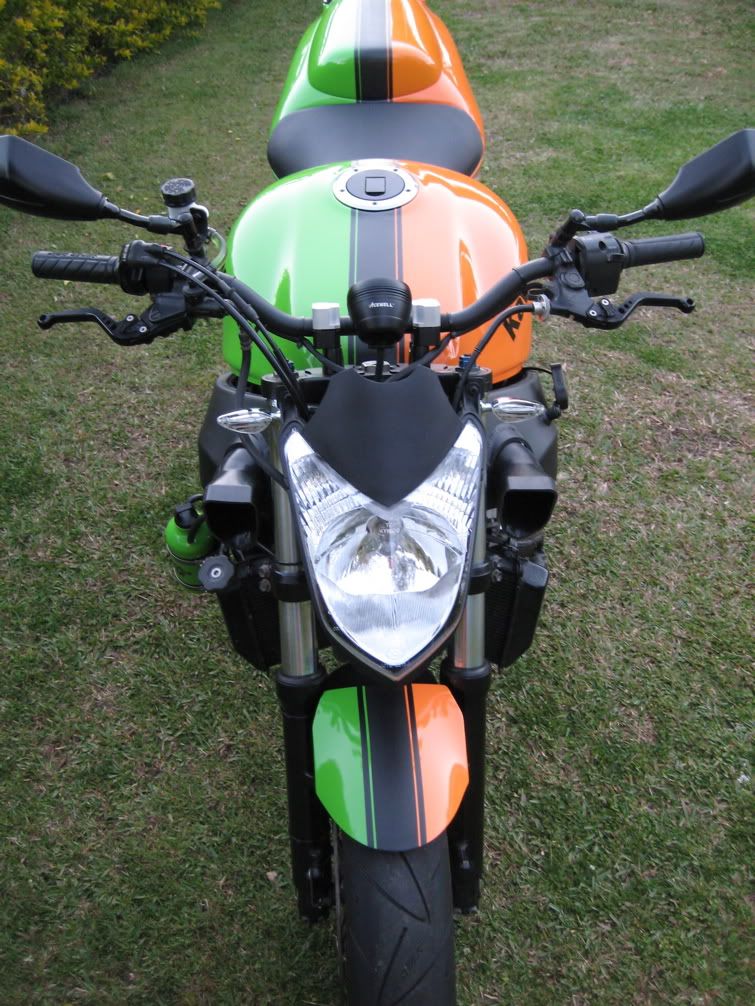

    I bolted some clamps on my fighter as well:
    Had some plate underneath and it was pretty solid.
    I think he'd be better off welding up some mounts on a Ninja bracket though:
    Would probably look a bit tidier with the weld filling in the "gaps"

    Pretty clean fighter there Hillsy! Is that the ZZR600? Yeah Probably going to drill and mount handlebar holders and weld it. Then make some block of plates for the "holes" that'll be left over from the old bars. After sanding and powder coating it should come out nice.
