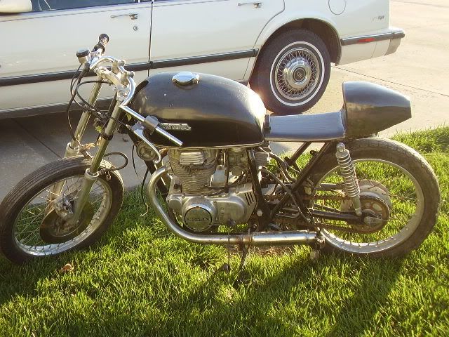

    I had never heard of a cafe racer until I randomly came across this pic
    I sweat this bike. For the most part that's what I want mine to look like. At least I think so, I'm trying to get more pics of that tank and seat
    Senior Member xander450's Avatar
    Mar 2007
    Madison, Wisconsin, USA.
    278
    Lucky for you, you have cheap taste. Almost everything functional on that bike is stock. From what I can tell:
    - bars aren't stock, but it's hard to tell what they are from this angle... could be clips mounted above the triple clamp, could be drag bars with a bit of pullback, hard to say.
    - aftermarket mirrors
    - modded, painted front fender (or aftermarket w/stock bracket)
    - a/m seat
    - no rear fender
    - can't see it, but taillight can't be stock unless mounting changed
    - cylinders, head, right engine cover painted black
    The tank looks stock. If you've got a stock 350 in solid shape, you could get from where you are to where this bike is very easily.
