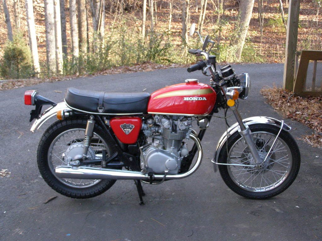

    Hi all. been watching the forum for awhile and you guys seem very knowledgeable about these old cb's so I decided to join.I bought a 72 cb450 a few weeks ago. a little bit of work and I had it running good.
    ,breaks,cleaned petcock,spark plugs. that's all I had to do.Drove it around for about 20 mins.It was parked for 2 days when I went back to it I couldn't get it to start. did some checking and I have no spark in one cylinder.I changed the spark plug and still no spark.I'm guessing points/coil/condensor but I don't know where to start. Any help is much appreciated.

    man, that thing is gorgeous. where'd you find it?
    As for spark, I'd check the coil(s) - you can measure the impedance of the coil if you have the right tool - if it's off, the coil is bad. They're not that expensive, and you can probably replace the pair of them with coils of the proper impedance from any auto parts store. You can't replace just the wires on the stock coils, and if they're original a break in the wires is likely.

    Thanks for the compliments .The story is that the bike sat in the window of a motorcycle shop (advertisement) for 15 years or better it only has 8000 miles on it.
    somewhere in N.C. Also thanks for the info if coils are reasonably priced I'll just go ahead and change them.They probably are stock.Any idea on what the proper impedance should be?
