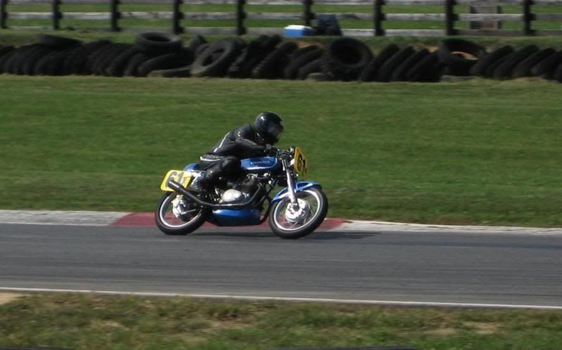

    Here's a picture of Tex's CB350 with a Tannermatic pan:
    Jim
    Administrator texmawby's Avatar
    Oct 2004
    10,737
    the absorbent pad is a must....IMHO!
    thanks for the pic jim!
