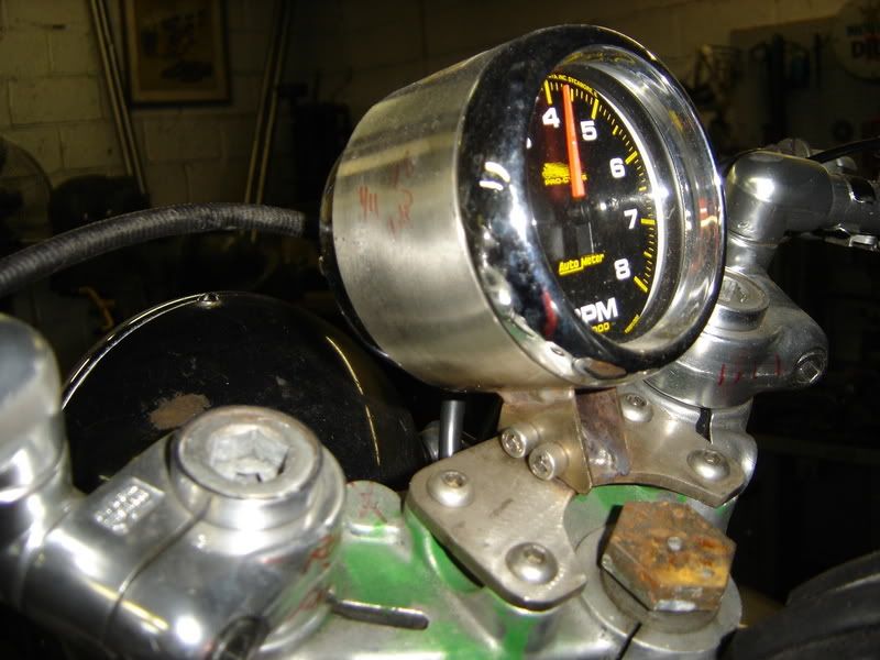

9
I don't pay any attention to any of the azz on the shoulder rants about the clubmans
it's not like I see all these guys using clip ons whittling out at least a one off top tree sans bar clamps
come to think of it, seeing my marzocchi trees with bar clamps still in place but using clip ons almost made me puke until I mounted my tach with those four holes and covered it all up
and makes me not a bit of difference either way because I have a bad attitude maybe
hadn't clad the lower portion yet while I was acting ugly on these
