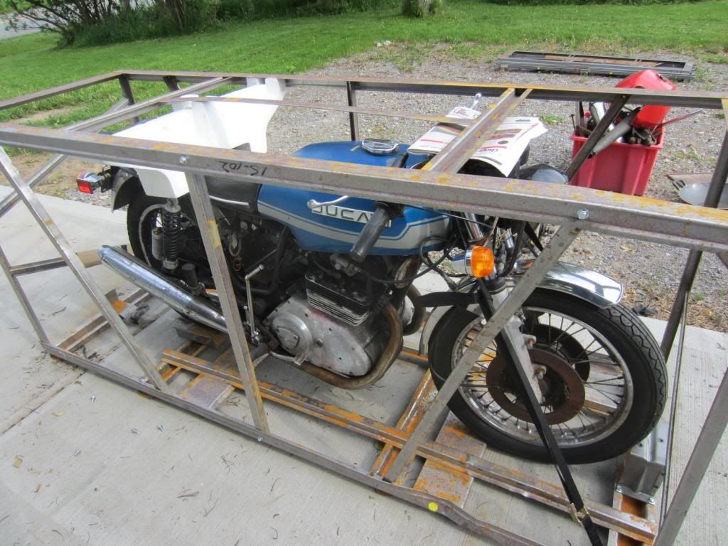

Hi all, For the last 9 Months I've been working on my 77 Ducati 500GTL. For the longest Time I didn't know the direction I wanted to go
with it. Restore it to original, just get it running and use it to beat around or make a cafe racer out of it. I finally decided after pulling it apart and polishing some parts that it needed to be a café racer project. The first thing I did was to make sure the engine was solid. After changing the points and some marvel mystery oil the engine came to life. Though the compression was down It was running. No oil leaks and running I was confident we had a winner. After about 30 min of running I check the compression at it was just about up to spec. I was very happy to see that. So Dis assembly began. Starting with the engine and before I knew it she was down to a bare frame. Lots of cleaning and replacing nuts and bolt was ahead of me. The first pictures are how I got her. She was rusty but complete. Ok the first day of working on her most of the day. I got the engine out now it's time to degrease the roller. 36 years of nasty grease and grime. It's like cement won't come off time for the pressure washer! lol. Someone left this poor bike out in the weather for decades. Lots of cleaning and polishing in my near future. Finally got the frame clean and stripped down. Its off to sandblast and paint. The frame will be metallic gold with black tank and seat. I'm not sure what style of tank and seat yet. The engine was the next target. Soda blasting and cleaning is the first thing then panting and polishing. I have about 15 hours into the engine and frame so far including checking all the things that were important (everything looked great inside the engine), paint, new gaskets and polishing all the aluminum. The engine came out very nice and just needs a few more things to be finished. Next all the small parts need to be blasted and prepped for powder coating. I never thought it would end It felt like I was sandblasting for a week lol Every nut and bolt ,brackets, hubs and rotors etc...

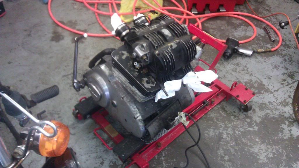

Im curious what you did to the engine to make it less "explode-y". I'm also curious if yours leaks oil anywhere.

First of all the bike is not finished. I reposted this on this form because I had built a CB750 a few years ago and posted it here and met some nice people one of the guys I met shot me an email and encouraged me to post it here too. Sorry if your offended that I posted it in a couple of forms. Seems like your just a hater. I really don't care if you like my "manx style tank and bubble back seat" I have over 150 Hours into going through this bike, sanding, cleaning, polishing, gold leafing etc... so your comment about a tank and tail on a stock bike is idiotic. Seems like you never restored anything. You don't have to Fabricate a custom frame(which I have done on other projects) or add big carbs and engine parts to make a bike worth working on. My bike has over 10000 mikes it does not leak oil and runs great. It's a fun little bike to run around no one said it was the most high performance motorcycle out there. I put over 500 miles on it prior to tearing it down. When the engine was out of the bike I went through it. If you want to know how to make one of these run read some articles by Chris Bushell. Apparently your a Ducati expert. So I'm sure you know this already in late 1977 and 78 Ducati redesigned this engine. Engines with serial numbers 501656 and later are the ones redesigned. This means that my engine has the later type of cylinder head gasket, improved primary gears and most importantly the later type of conrods and crank. This means that my big-end shells are the same as 620 Monster ones. Maybe you should just take over this thread since you already know how crappy it will turn out.
I was poking a little fun. Lighten up. 150 hours? is that all? ok, you got a set of rearsets, some shocks, and a clubman bar too, but please enlighten me - aside from cosmetics what have you actually done mechanically? I am genuinely curious about that because the only reason I haven't ever bought one of these is because everyone I know who has had one, or worked on one, or stood near one had nothing nice to say mechanically about it. That is the one thing I have found missing from all your posts on all the other forums, you say "I opened the engine up, it looked ok, now let me tell you how I mounted this seat" (I'm paraphrasing here for illustration so don't wad your panties about being misquoted).
