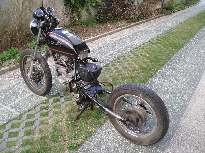

I am building my first bike and this is how it looked when I got it home. I got some parts and lots of them on the way in the moment.
Still searching for a piston kit, exhaust rocker and camshaft[B)]
Greg
602 Posts
That'll be the first Cafe'd hill climber I've ever seen! ;);):D

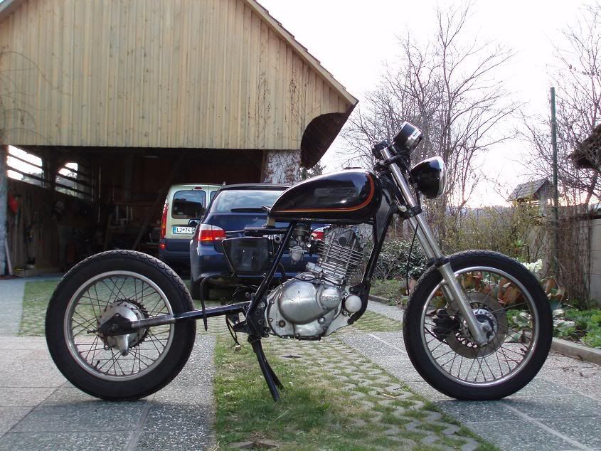

heres today progress. I switch to the new frame and made a rear brace. Also cut some wood just to see the stance. seems ok to me, what do you think? tail is next:)
4,721 Posts
how much travel do the forks have? they look very long even with the trees set down lower on them, almost motard or MX long
what is the height of the drop rump seat area?
just peeking...... it seems to have what appears to be a very weak headstock
I think I'd consider putting in horizontal duplex back bones which coincidentally were bent to fit any numbers of flat bottomed cafe-ish tanks
my inclination would also be to do this while raising that drop seat area and also lowering the ride height
but I only know what my eyes see at this point, not any hard measurements and I'm too sunday morning easy to scale it
looks like you have a decent tubing bender and can grind welds so why not
4,721 Posts
looking again, I just had one of the guys move a bigger 4 valve single out of the work area and into storage
I'll look at it and snap some pix but for some reason it looks like it would just about bolt into that frame
also what is the wheelbase with the current setup?
it looks like it wants it's swing arm shortened maybe two to three inches
use a smaller tank and keep the seat area as is
looks like it could make a really tight small cafe bike but not if you try to make it fit a big person
4,721 Posts
section to make shorter a common /5 /6 /7 BMW tank to make it fit that short backbone and fit over the top of some of the engine
sorta thinking out loud but jerking the keyboard a bit

well, I shaped the tail out of foam so I can put some polyester on tomorrow. I dont know about the fork travel, normal I quess, not soft at all. I found some specs..

I think I would put the fork tube back where they go........ and then lower the front by machining a spacer to limit fork travel internally
you can determine fork travel by removing the fork caps and removing the springs
then you can stroke the front end thru it's entire range
my guess is they have at least 6 inches, maybe even 8 inches, of travel and I'd be happy with 4 to 4.5 inches of travel
the result of internally limiting travel is the forks will effectively be shorter, and even stiffer..... cut the fork spring to make it stronger
I think I'd lower the rear with appropriate length/travel shocks
and use as low profile tires as you can get for it
thanks for sharing the numbers, looks like it has much potential and thanks also for telling about modification limits in your country
11 Posts
Discussion Starter · #16 ·
well, I was thinking about cutting the springs before, but I couldnt find anyone here doing that. And because springs arent cheap, I was kind of scared. Can anyone tell me how the bike will handle if I shorten them for couple inches? That would be nice because forks are long, I know. not sporty at all..
I will lower the rear only for 5mm(0.2 in), shocks are on the way already. hope the clubmans and engine parts will showed up soon;)
4,721 Posts
to shorten the forks
take them apart but only after you check the actual travel as laid out previously
then you should be able to see that if you put a machined spacer in the right spot
it will limit and reduce the travel
while effectively shortening the forks due to capturing, in the fully extended position, more of the fork tube in the lower leg
then all you have to do is whack the spring with a carbide cutoff wheel in a die grinder or whatever
smooth the end of the spring so it's action is predictably repeatable
when you shorten the spring it will be stronger and depending on how long the stock spring is and how much preload exists
it may very well be a good idea once the travel is reduced and will result in a firmer and more sporting ride
suppose you could always modify/move the rear shock mount if it then needed lowering in the rear to level everything out.......
glad to help if you have any other questions and I'm sure I'm not the only one here with a grasp on the subject
