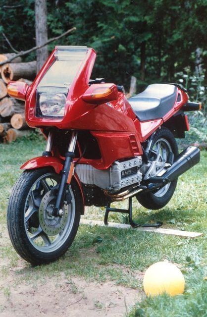

Just incase you need a reminder what the K100RS is suppose to look like:
<- ;) my k bike
<- ;) my k bike
Great looking bike ?
