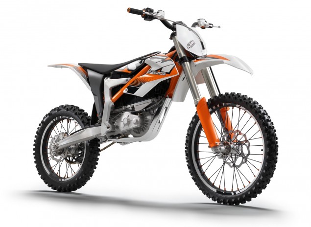

Where does the UK graduated license scheme stand on electric powered motorcycles?
KTM Freeride E electric bike, or if he thinks he can build one as good or better, that would be impressive, it wouldn't represent reworked antiques it would truly be engineering your own unique functional creation.
lol and you could park it in the house without it leaking gas and oil allover the place ;) which will make yer mom real happy.
