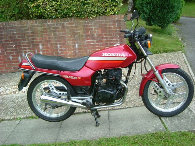

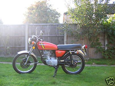

Here's a 79 Cb125 disc set up, direct swap:
Or with a nice set of boomerang Comstars from an 85 CB125s
