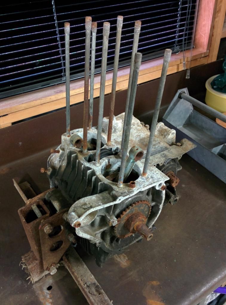

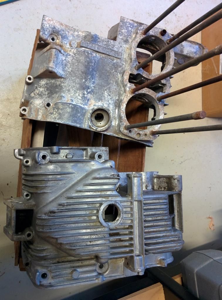

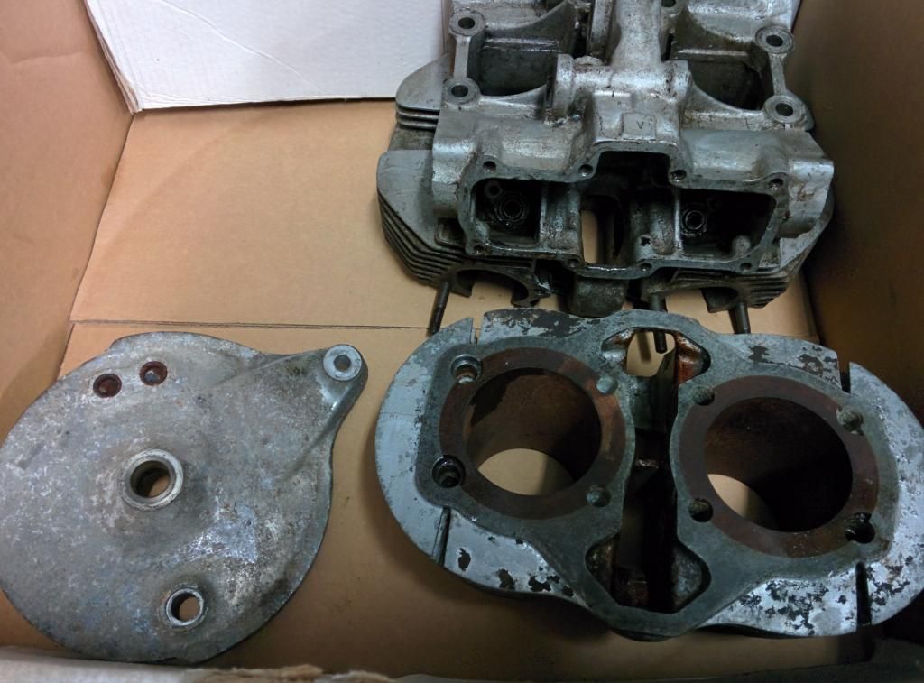

I was wondering why it had a tube full of Silicone in the fins?
After some excavation I found the cam chain had chewed through the tunnel and a combination of Silicone and rough arse welding had been performed to try and keep the oil in.
Sooo, junk the barrel and get hold of a nice used one and pull the whole mess done to it's individual parts.

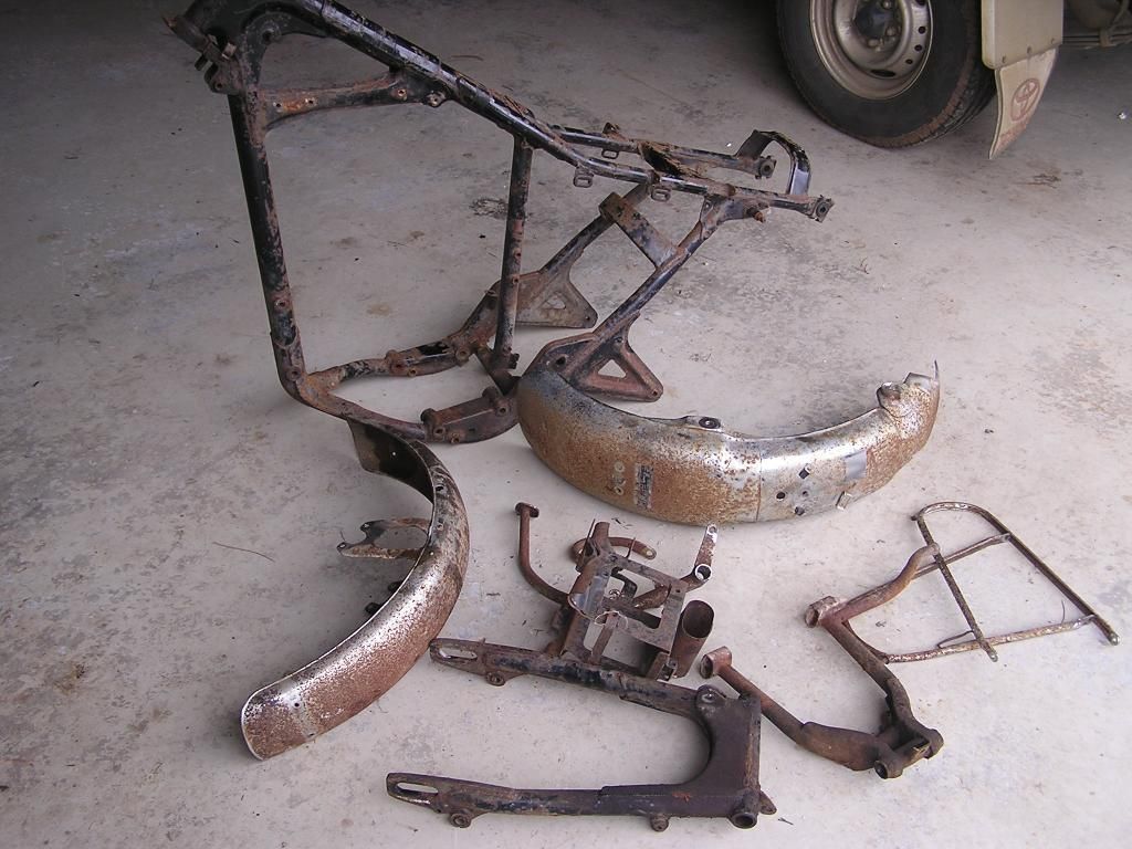

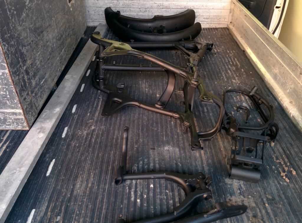

Having sorted the parts I intend to paint, I took this lot off to the sand blasters.
and two days later...a nice cleaned and primed pile of parts.
Next job was to strip the engine and see what is salvageable? Lucky it came with it's own engine stand!:p
Crankshaft is stuffed (Rods frozen at the big end and the small ends badly surface rusted.)
I thought the head would be OK, and I think it is, except for a cracked exhaust stud mounting...should be easy enough to weld up though?

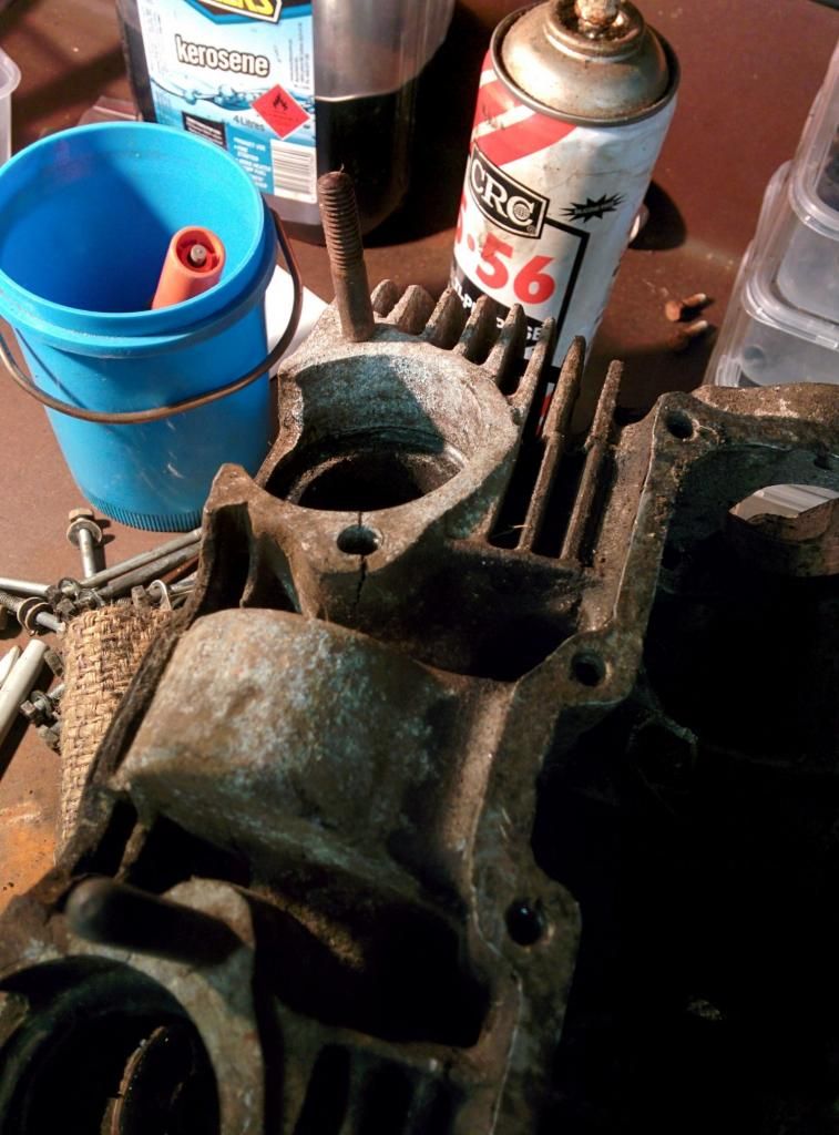

So as of today I have a few parts to take off to be vapour blasted as I'm too lazy this time to scrub 'em up by hand.
Though I did give it all a wash in Kero as it felt plain wrong to take them the way they were.

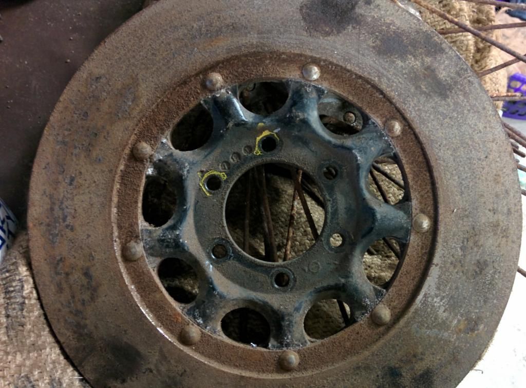

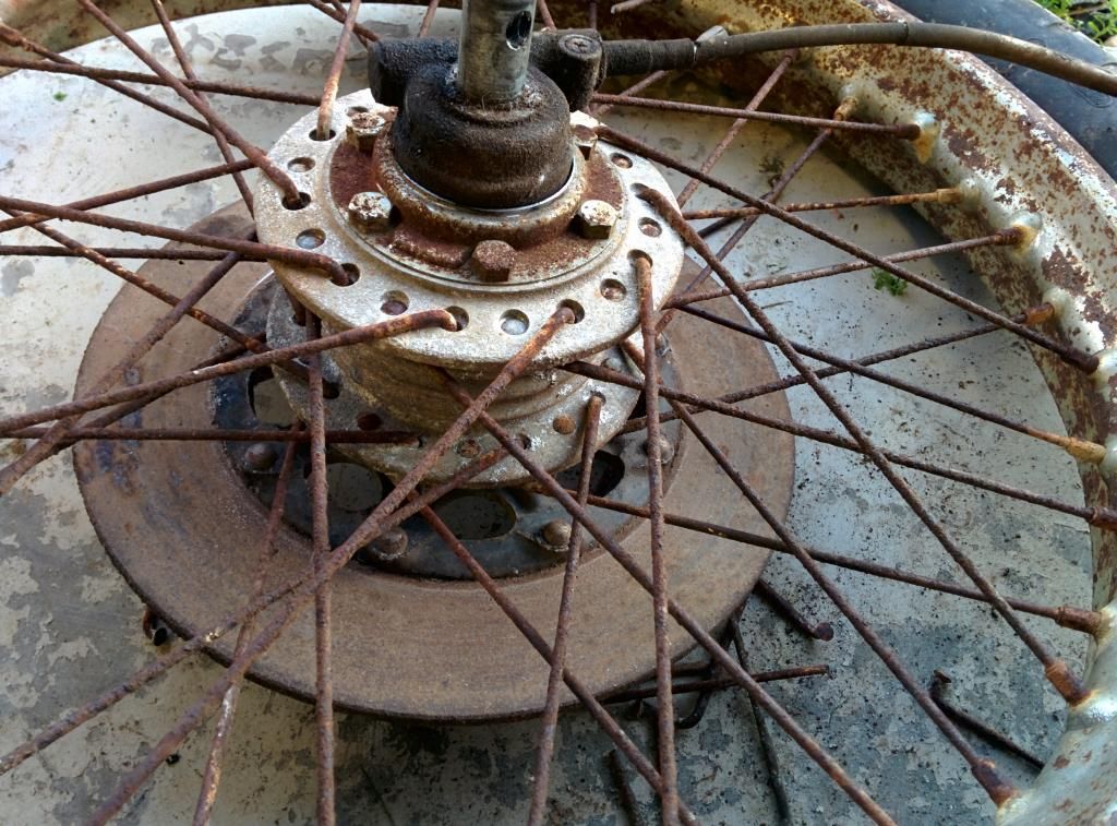

Front wheel's seen better days..
But under the muck there is still the Yellow paint on the thread ends and under the lock washers
the rear brake also looks fairly good where the crud has protected it

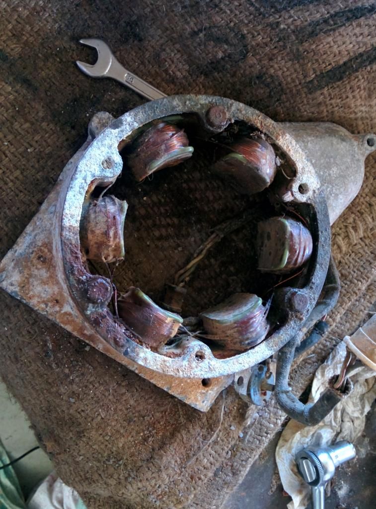

Not so sure whether or not the stator will live again....

Don't trash that barrel. It may clean up just fine to use, if you rebore it and go for + .75mm oversize (or bigger) pistons. A used barrel may not be that much better.
The first big rule with playing around with old motors is never throw any part away. Just about anything can be reclaimed if necessary. Don't assume you can always find the used part you require.
Don't let any blasted parts sit around to rust, even an oily rag is far better than nothing.
A good ally welder can fix just about anything.

Anyone know if those cheap Stainless spokes are any good? The ePay ones that are around $30 a set? They aren't the butted type, but should they be?
Plan is to use alloy rims and SS spokes at this point.

I wouldn't use cheap SS spokes fromwhoknowswhereBay, even quality SS spokes can be brittle and break in use. Don't be surprized if you can find some NOS OEM Honda spoke sets somewhere on the net.
Ask these guys about spokes: Central Wheel Components Limited It's worth a read, anyway.

I got my last spokes from Buchanan's for the Z9 and was happy with them....I guess the lure of price had me thinking about the ePay items.:)
Current plan is to use maybe an old "mud catcher" pattern Akront rim (which I see are now made by Morad), with a butted SS spoke.

Personally I'd prefer to use quality chromed spokes. They are a fraction too shiny, but SS spokes do dull and corrode with time. Stainless means no rust, not really no stains. Even the highest grade marine grade stainless deteriorates in time.
