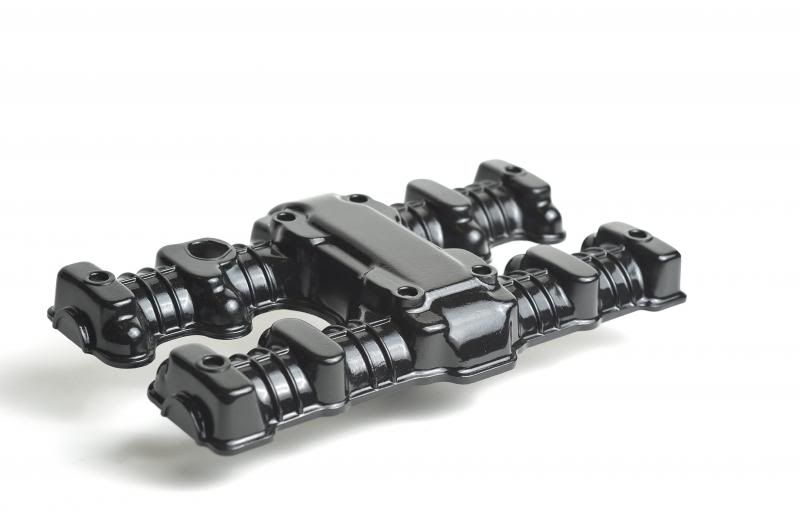

Cleaning it up on the exterior with soda blasting and stripper/wire brushes:

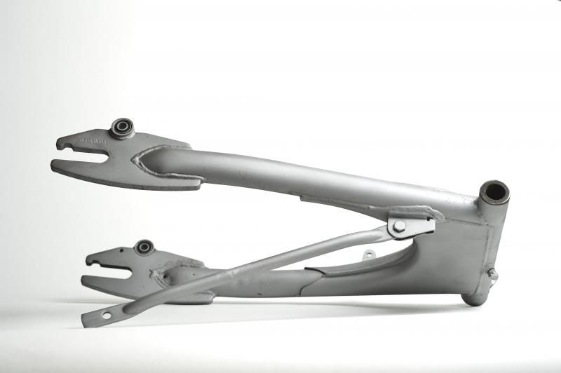

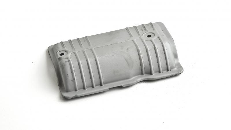

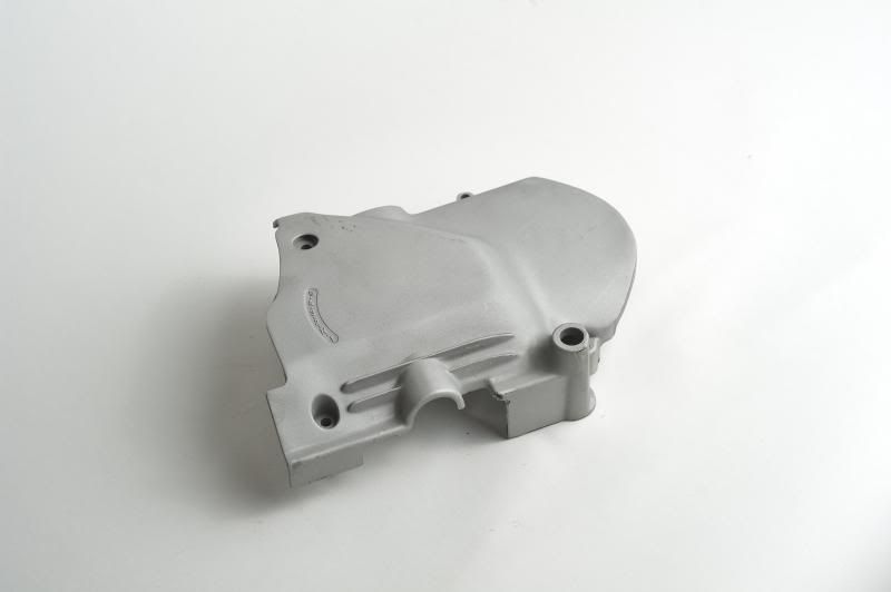

Sandblasted and re-painted some parts:

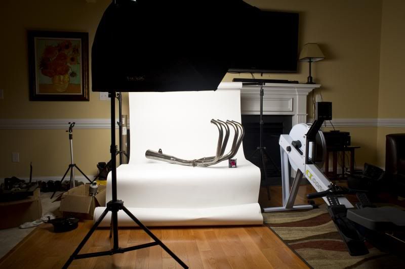

I'm not totally sure where this exhaust came from, looks like a vance. 4-1. (but mine has a bit tighter radius on at the head. )
All I did was clean it up a little. Baffle still installed.
If I cut it out, I can mess with the jets a little.
