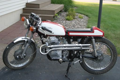

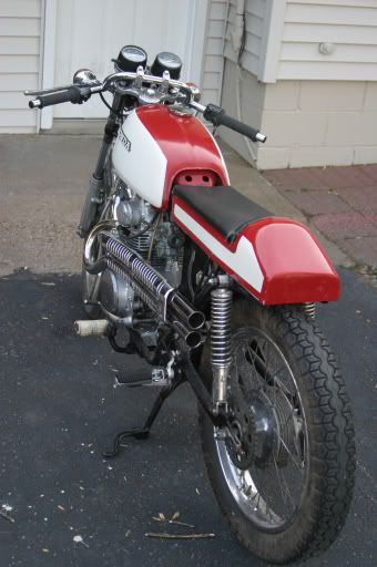

Hey folks,
been hangin out on another motorcycle bbs( wisconsin motorcycling .com)heres a few pics of my 72 cl175 cafe project...taken in may or so:
Since then iv'e worked out the rearsets(both sides)installedUni pod foam filters,the tail light/turn signals/ license plate,its just too much fun to ride!...And sounds great.<img src=icon_smile_big.gif border=0 align=middle>

Put on some alloy wheels, a glass tank and fenders, a couple of Kehin 24mm carbs off a SL350 K1, some real rear shocks, some 15-20wt oil in the fork, a 305 superhawk front brake....and you'll be amazed what you can do with that bike.
