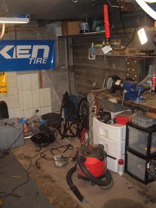

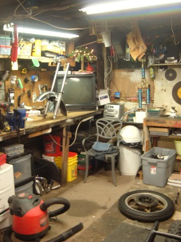

So first thing we had to do was clean up our work space. Both the bikes are at my house and i have a 3 bay garage ..on the side of it is a small workshop It was full of SHIT, car parts, furniture, tools etc etc like jam packed. We cleaned it up in one night and moved everything to one bay of the garage.
This is what we ended up with.
that is all for now tune in for tear down pics.
