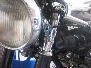

At great risk of offending the racing purist I'll go ahead and post this. From reading this forum for sometime now I know that some of you are just trying to make your ride look cool. I pulled the headlight "ears" off of my 350 (because they're ugly) and bought aftermarket bucket mounts. This left the upper forks bare and although you can clean them...over and over and over to keep them looking ok, I was looking for something cheap to make them look good. Enter Home Depot. For $5.00 I bought 1 1/4 chrome sink drain pipe and cut it to length to fit between the triple trees. A little duct tape made up the slight difference in diameter.
I thought it looked pretty good and it was cheaper that a chromer. And yeah, I know, those are clubmans.
