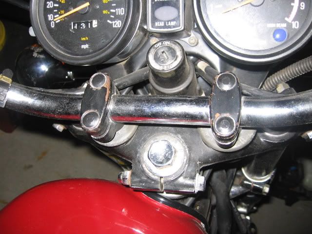

I know you are all figuring that I am gonna ask the age old question of clubmans or clip ons but not a chance. I am actually going to ask if a set of drag bars would be comfortable with stock foot controls on a Yamaha XS650? Also I wanted to know how difficult it would be to transfer all my controls over to the new bars. This is my first bike so any pointers or help is much appreciated. Also if I am looking to change the grips ant hints on what I should use to help slip them on to the bars? One last question is that on my handle bar clamps there are little plastic covers over the bolts, I was wondering how to remove those covers. Heres a picture for clarification.

changing controls isn't all that hard. They're 2 peices that clamp to the bars, just remove the screws from the bottom and they'll come apart, the throttle grip will come off also once you take apart the right side controls. Just make sure you put it all back together right!
As for the plastic covers on the bolts, just pry them off with a small aka "pocket" screwdriver.

I run drag bars on my cb750 with stock foot pegs and they work and look great. At 50+ mph I get an air cushion that supports my body off the bike which makes it very comfortable to ride longer distances. Handle bars are pretty much a snap to install. If your wires are internal to the bars, you will have to fish them thru the bars. Some bike hand grip assemblies use a little pin to hold them into position on the bar. If your stock bars have this hole - you will need to ensure your replacement bars have the same holes - If not - you'll have to drill these holes. You can get the exact placement from your original bars.

In this case I would repaint those bar clamps (use rustoleum sem-gloss or gloss black). I would also take the time to clean the inside of the handlebar controls (be very very very careful as internal bar control wiring is very delicate, use compressed air at about 5 psi and alcohol on a q-tip) and address any corrosion (small wire brush). Additionally I would inspect the wiring for any breaks that need addressing or bad connections. Use some simple green or windex and just give the hard to reach areas of the bike that will now be exposed with the handlebar off a good solid cleaning because who knows when you will be able to do it again.

Also now would be a good time to replace any philips head screws you come across with stainless steel allen heads. what I like to do is make a drawing of the control on cardboard and then push the old screws through the cardboard at the exact point on the diagram where they would be in the control. That way you know exactly where everything goes when you put it back together. Most of these screws are going to be fine thread metric in odd lengths so you will likely have to go to a real hardware store or fastner specality store rather than your local home depot or lowes (although I have gotten lucky there with fastners from time to time).
