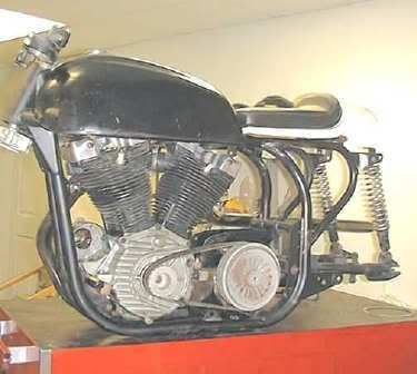

a peek at the twin port induction

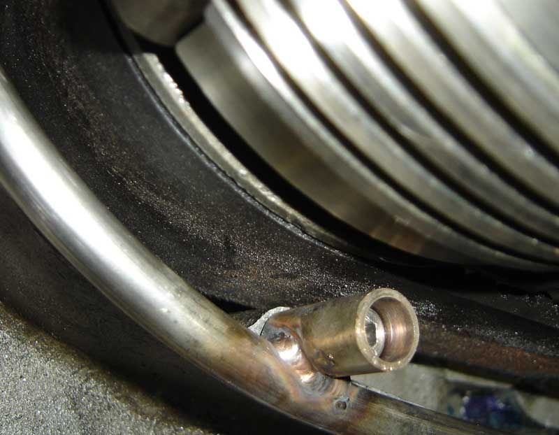

ultra close up of the Duck Alt, the allens are 1/4 20 for a size reference and that's all stainless

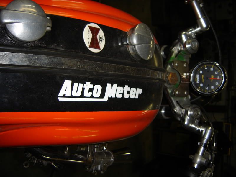

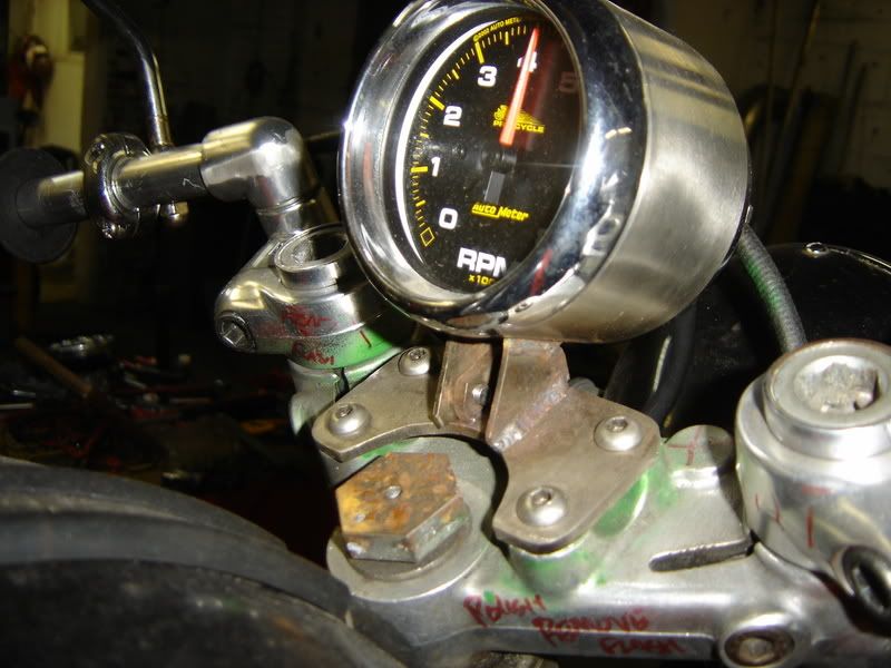

Autometer was kind enough to toss a tach at it so I made the stainless mount, the tach is isolated in live rubber

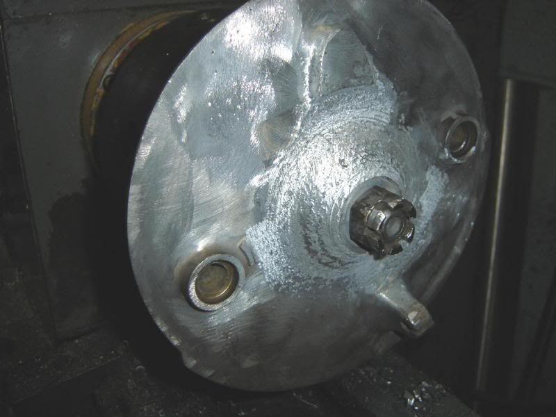

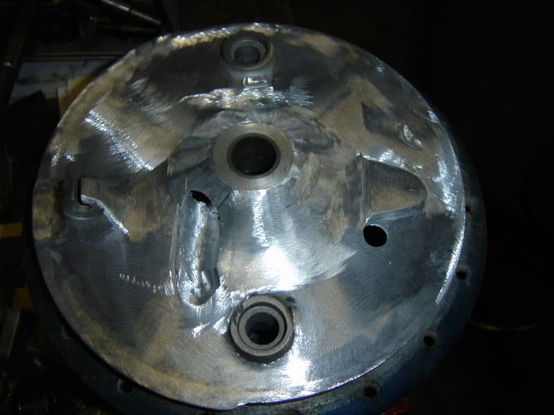

welded up front backing plate to make the rear 2LS.... certainly in the rough here, speedo drive holes and such filled in
this stuff these old japanese backing plates are made of isn't the greatest to weld

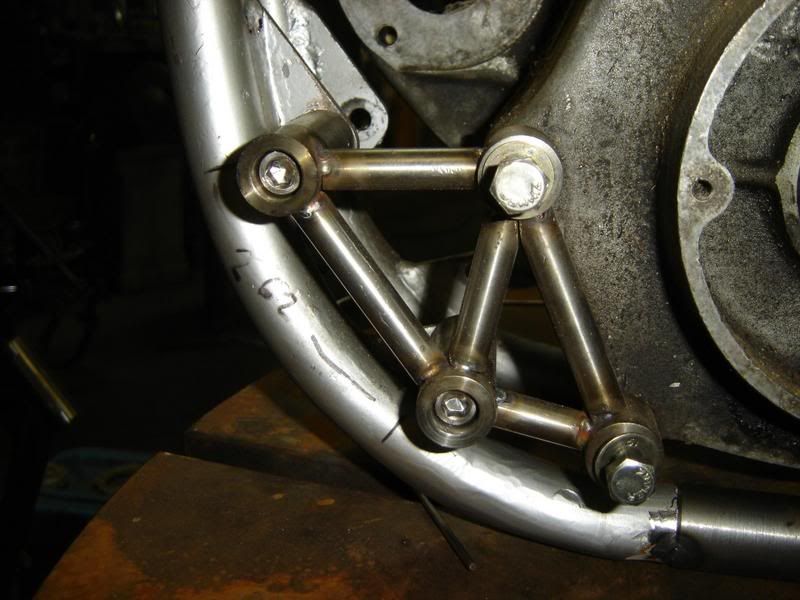

Ti engine mount, the front ...... rears are pretty much the same but also cross braced to make it just that much more impossible to weld

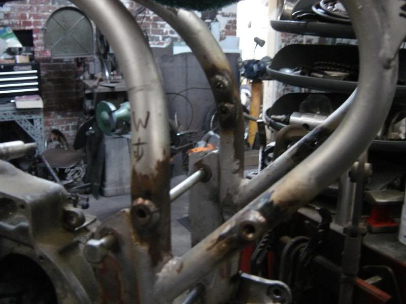

lots of big holes drilled in that frame

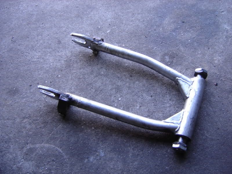

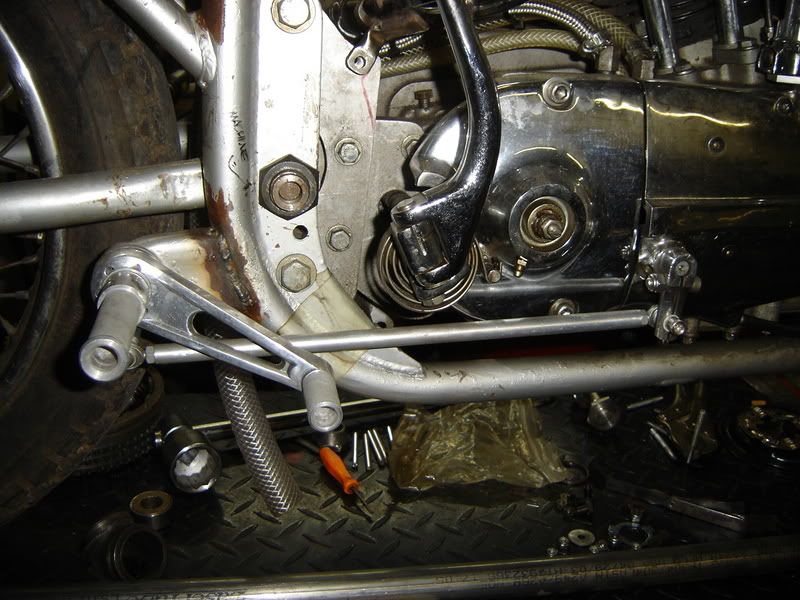

an observant eye will see the swingarm has been "flipped" because the bike is right side drive, fully adjustable timken setup for preload and side to side, all one off pieces and a pita

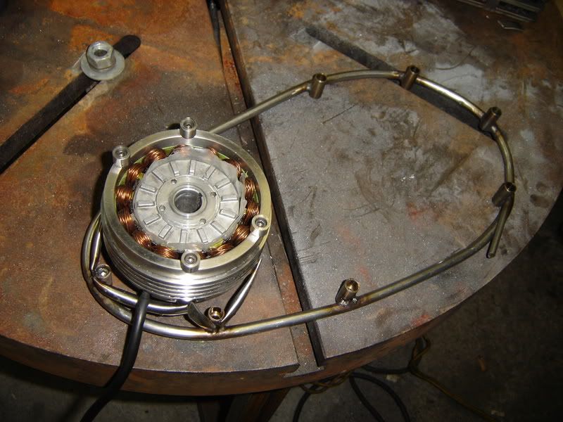

in progress charging system, lots of juice and no stupid genny
random Lucas alt on a HD flatty so you can visualize how this is done
I wasn't fibbing about the induction, it works very well

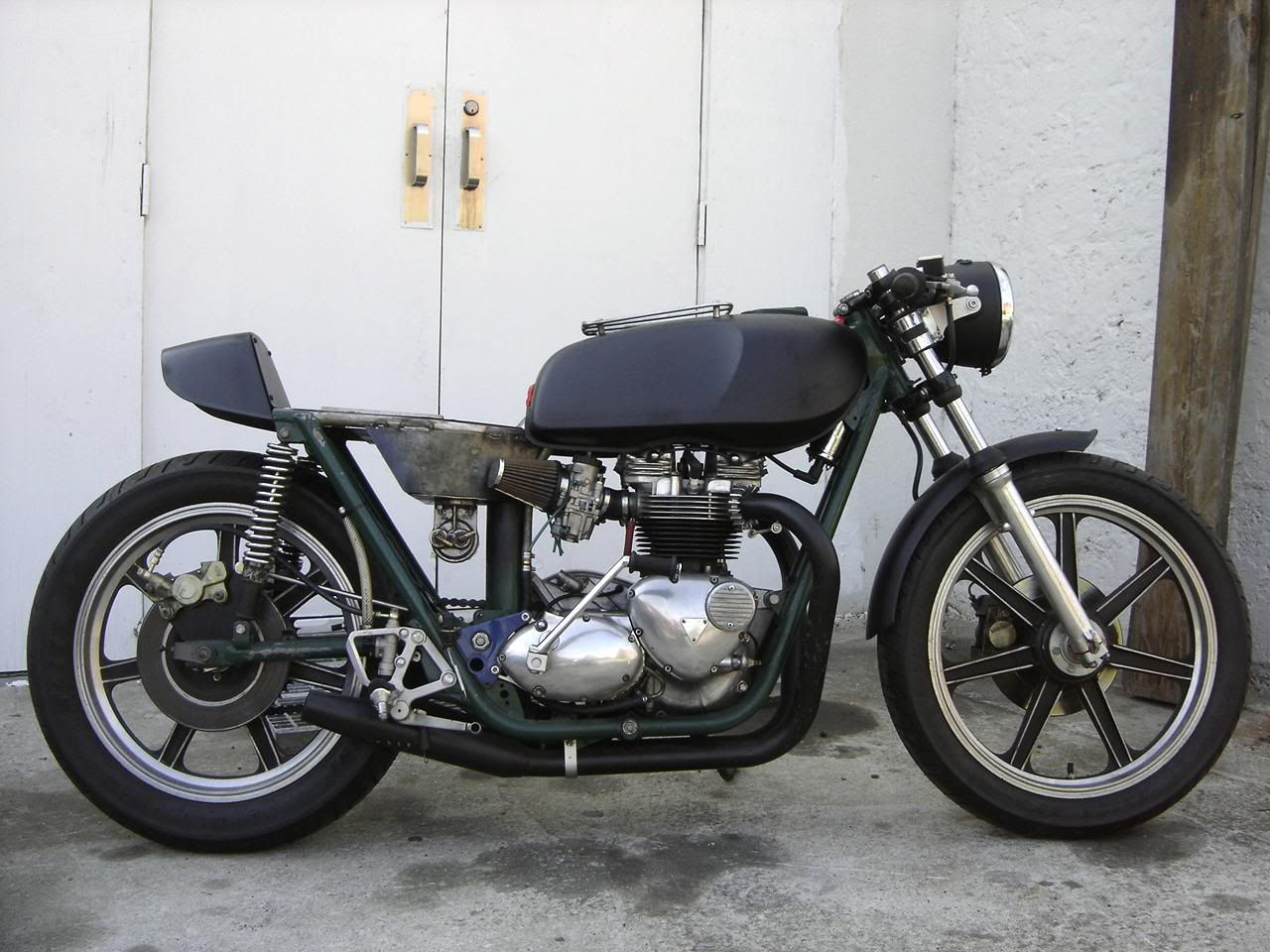

next to my slammed and taut T140D cafe

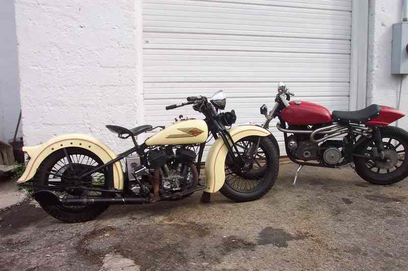

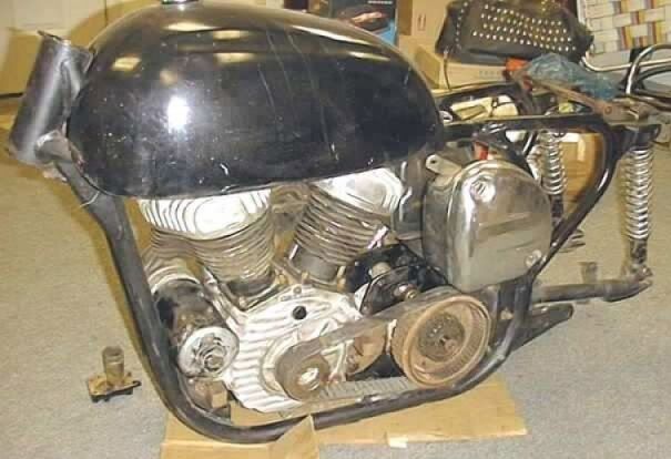

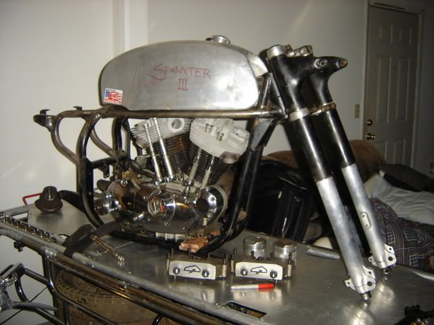

bigger OHV engine on flatty bottom
same bike again with an old codger, that VL runs pretty darned swift for such an old one too
very early pic of my T140D cafe, I'd like to talk to the guy that started this project, it's come a long way from how it was when I got it
