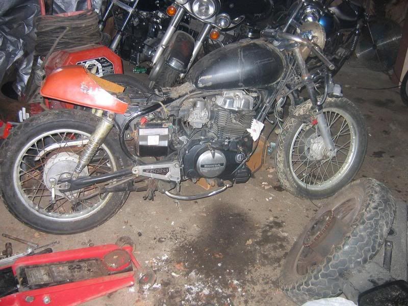

Kind of new to cafe racers. I am working on my second Honda cafe project. Here are some before and after pics of both. The 750 was the first one I did. The 450 I started today.
um...which one is the 750? all I see are 2 450s and no finished pics. Good start on them though, and good luck with that 82 450sc nighthawk - honda really ran though the ugly forest with their eyes closed when they bilt that sucker.
edit: wasn't smart enought scroll sideways before posting. Nice 750. I would like to hear more about the cbr wheel conversion you did on it (and the forks too it looks like).

3rd and fourth picture are the 750. Yeah that 450 was an ugly one. I only have about two hours work in it so far. Just changing the stance with the shorter tubes made a big difference.

Thanks for the welcomes and the compliments. I am just getting in to cafe racers. Don't know much about them really. I make stuff up as I go. I have been a chopper guy all my life. I also like building jap chops out of Yamaha twins

Geeto, The CBR front end bolts right on with minimal mods to a couple spacers. The rear was easy too. Had to add brake brackets to the swing arm and grind out a small bit on the inner part of the swing arm for tire room. The cush drive was machined down for chain offset. The CBR rearsets just needed a bracket welded to the frame.
I have a set of 1997 F3 trees and I was going to do a stem swap - a couple of spacers sounds much easier, got any more detail on that?
what size rear tire is that. I have heard that some cb750Fs can take a 160 and others can't.

From what I remember we used the CB750 bearings and races. The bottom inner race was machined down about an eigth. There was no room for the lock nut on them stem under the tree, so it was just loctited. I forgot what we did on the steering stop. The rear tire was a 160. It rubbed the chain some. There are offset sprockets available though. This bike was unfortuneately wrecked last summer. My buddy hit a deer on it at 55. I have another one in the works that has an RC Eng. 1090cc big bore motor in it. I don't have the money for that build right now. Those forks and wheels were an expensive swap.
how bad was it wrecked? are there some parts (ie the rearend setup) that can be salvaged? I hope your friend is alright. I find that an f2 rear wheel with a 140 or 150 rear tire is a better setup because it just clears everything.
