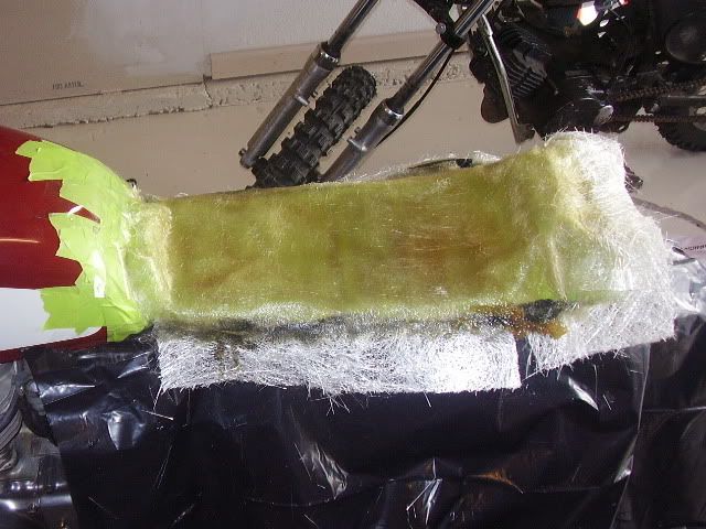

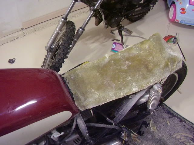

ok so here is my seat. the pictures explain the best, but I covered my frame and laid glass on it to get my shape.. it's rough at first so I trimmed it, and laid a second coat. now I have installed the hump but I don't have that photo yet.. basically I glued the foam to the seat pan I made and covered the whole thing in glass
the frame
covered in tape and release agent to keep the bike clean
first coat
I removed it from the frame and put a second coat
two coats and trimmed ready for tail hump

these photos look crappy.. it's not as rough as it looks.. but it's a basice seat pan.. after I get the glass done and get it ground down. I'll get some more photo's

Right On. Nothing a bit of bondo can't fair out:) You can also mix up glass microspheres with your resin to make a bondo-like slurry, a bit cheaper.
Looks like you used glass matting and polyester resin? How are the mounting brackets going to work?

well I think the mounting bracket should be really easy. If you look at the pic of the bare framet, here are two tabs and a bracktet that goes across. they are already threaded, so I'm goin to get some small button head allen screws and bolt it down flat that way. then my seat cushion will snap on and I can unsnap the seat cushion to unbolt the pan. I won't have any electronics to get to really so the seat doesn't need to lift up or anything.
yeah I just used mat and resin.. hey where do you get those spheres, that would help a lot. I don't want to add a lot of green resin jelly cause it's soo heavy.. I'm trying to keep it light!

Not sure what the green resin is that you're referring to. I use a mixture of regular old epoxy resin with the microspheres to a thick, spreadable consistency and sand away once dried.
For light weight considerations, you might want to do a layup using a vacuum bag, wrapping your piece in peel-ply and some layers of breather cloth to squeeze out and soak up excess resin. I recently wrote an instructable on a low-tech implementation of this process here:
http://www.instructables.com/id/Vacuum-bagging-basics.
It's a bit of messing around, but you get a good resin/glass ratio in the end, plus the pressure of the bag helps eliminate any lift-off of fibers, and also bubbles...

well I try not to use much bondo.. so when I said green resin jelly I was talking about the green fiberglass made by bondo that has the strands of hair in it.. it works awesome but it is freakin heavy. bondo absorbs water if exposed, so I try to keep it out of my bikes as much as possible. yeah the vacume bagging soundes cool but I'm too far along.. I'll get some pics up tommorow. thanks for the info
