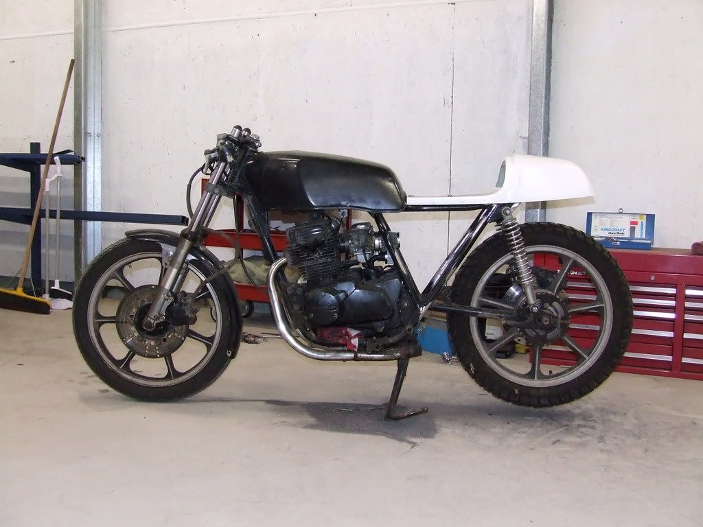

Hi guys, new to the site. I have hopefully stuck on some pictures of my Kawasaki Z250 as I bought it and as it is currently. It is getting the usual list of mods inclucing cut off rear frame, replica Ducati tail section, smoothed frame, pod filters, loud exhaust, tingate clip ons, etc. I have never heard this thing go, it hasn't been ridden in ten years. Next is to mount some rearsets, get it running to make sure everything is right then the big strip to paint and rebuild everything. I can't find much evidence of kwaka cafe jobs, is there a reason for this? I'd be interested in any comments or sudgestions.

Already looks about 2000% better!
All the lines work nicely. Have always loved the SS tailpiece.
What you going to do about the battery?
Glad you've gone for clip-ons too.
Nice one :)

the work you've done has worked wonders, i cringed at sight of the first photo. let me be the first to say, if you haven't heard it run yet how do you know you're not investing time and money in what may serve better as an anchor than as transport. some here will agree that you'd be better off waiting on the rearsets and what not and make the damn thing run. for one i find it helped to see and hear my bike run right in it's stock form so when i started making changes i could tell that my mods were the source of the problem. right now you are adding more variables that you may have to sort through on a bike that you are unfamiliar with. just some food for thought...cheers

Wobbles- Thanks for the compliment. At this stage engine will be black or gunmetal. I'd like to polish the side covers but need a new right side as it has been damaged and repaired...badly. Wheels will most likely match engine, black frame and kwaka green for the body work. Clip ons were the only way to fly, a bit hard to find the right size but they look way better and avoid the imminent ridicule of clubmans. My battery will either be twin six volt units in the tail or a single twelve volt unit under the swing arm just behind the gearbox.
Snorkelfork- I take on board what you have said. The bikes history is known thru a friend so I shouldn't be in for any huge suprises mechanically. Rearsets are my only mod before I get it running only because I want to check riding position so it is actually rideable. I'm anticipating carby problems due to lack of use, lack of mufflers and podfilters. I'm lucky enough to work with a fella who is a tuning guru that can help get it sorted.
