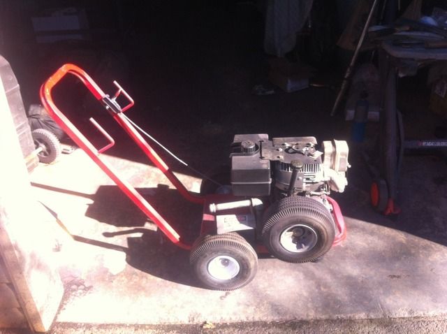

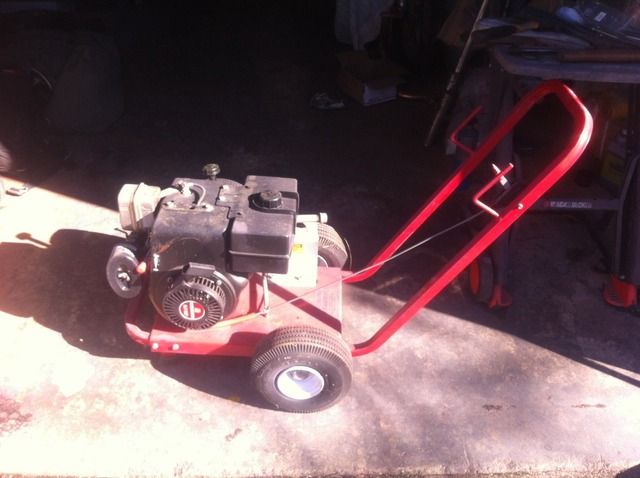

Last week a customer of mine started talking about his past racing and mentioned he had a few things he was wanting to get rid of to save some space. The next day he dropped off a Pit Boss front fork stand and this Honda starter.
I still think after building the roller starter that I will end up making a hand held unit. The above starter requires 2 people. I much prefer to start the motor in neutral than in gear and having to go through the extra motions. It's nice to be able to plug the starter into the crank snout and spin to life while it sits on a stand or the kick stand.
