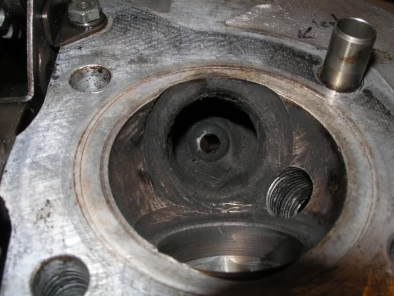

I'm currently rebuilding mine I got off ebay for 300 bucks. The head gasket was leaking so I decided to rebuild the head. the exhaust valve seats where gnarly, so I lapped them, but one side is still leaking (i poured gas down the ports). Should I just relap til the leak is gone?

Mcook,
That seat doesn't look to bad after you worked on it. Contact area on the valve and the seat look decent. I see one area down around the plug may be a tad rough.
Gasoline is kind of thin for checking valve seal. Typically a light oil is used. Maybe lap it a bit more with some finer compound if you can find it. Doesn't look like the seats need to be recut. Remember..put a decent amount of pressure on the valve when you check it. Also remember that the valve will pound itself home a bit during run in. After lapping I usually slap the valve down in the seat a few times before I check the seal to help smooth out any microscopic high spots.

PS. Remember to clean the compound off really really well before you check the seal...just a single tiny grain of compound will cause it to leak.

thanks. I think it could have a little compound left on it since it's was freezing in my garage when I did it.
