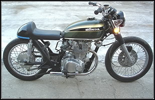

I figured I would do a mini thread to show the progress of the CB450 project thus far. Remember, This project is up for grabs if anyone wants the bike "as is" . If not, I am gonna finish it and ride it untill sold..
Here we go:
Starting point was a 6000 original mile 1974 Honda CB450 DOHC..
I got the bike complete (minus the seat). Everything that I was not going to use was removed and sold on Ebay, and various sites I am on.
The first major project was to get the bike lower to the ground, and this was achieved with 11'' short shocks in the rear, and pushing the tubes up front thru the triple-tree's about 3''. As you can see the bike is slammed (which is the way they all should be) -->
Then I got bored and started tearing into the bike with my grinder and trusty sawzall..All brackets / tabs / and anything else I saw fit was removed, sanded down, and covered with a few coats of Dupli-color low gloss engine enamel. I have had great luck with this stuff, as it is almost like powdercoating in a rattlecan.

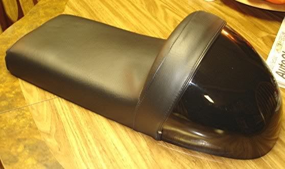

Next issue was to mount the seat.
The seat I got came with a pad, so that was one less thing I had to worry about.
The framerails on the bike had to be cut to allow the seat to fit. So that along with some grinding and all was good. With the bike being so low I had to take out 1'' outta the bottom of the seat to prevent seat to tire "love". My guess is I am gonna have to run the rear shocks on their hardest setting, but the look will be worth it.. A "tray" was made to clear the rear wheel and also mount the battery and some electrics..Also the sidecovers were removed to go for that clean " no sidecover look".
A pan was made to attach the seat too, along with to mount the electrics under (and out of sight)..
The inside of the seat itself was built up with hardened wood, and then painted black to match. The whole seat/tray combo came out really really well, and works even better.
The rearsets (which are about 80% complete at this time) were almost too easy.
I took a trip to the local sportbike junkyard and scored a set of controls offa 2001 GSXR.
All I did was bolt them into the pass. peg mounting holes, and then cut down/off the stock mounts..
All that is left is to make up the linkages, and I am done (the one in the pics below is just a piece of wire for mockup)
Allot of other things have been done to this bike to get it to it's current state...
Things like a smoothed out top triple tree, clip-on's mounted above the top tree, ultra clean master/universal throttle and clutch perch, etc..Still waiting on my grips (will be the same as these, just black) --->
Here's some pics of the new sealed battery in it's new home, under the hump of the cafe seat.
We built 4 supports to hold the battery in place, along with a strap over it to insure it wont be going anywhere...
That along with the trailer box all sits under perfectly, out of sight...
Got some real K&N filters for the scoot, as I cant stand those cheap ass Emigo filters that everyone uses..
(still need to be oiled) -->
And here's some final pics to see how the bike currently sits/looks...
All that is needed to get this bike finished is some time, sort out the wiring, finish the rearseat and exhaust, and other little BS things here and there...

My new Avon RoadRider tires are mounted and back on the bike. Def. give the bike a "beefier" look/feel than before. Sizes are 120/80/18 in the rear and 100/90/19 up front. The 120 def. fills up the swingarm nicely, compared to the pizza cutter that was on their before. Along with that we got alittle speed hole crazy on the rear of the bike while the wheel was off (see below). More speed holes to be drilled as the bike progresses.. ;D
Below is the 1st of many videos I am gonna host of the bike so you guys can hear what the "Franken-Exhaust" sounds like. This vid was shot about 12:30am with my buddy Danny putting the bike thru the gears down Western avenue..You really cant hear just how loud this little bike is, becasuse on the video below the exhaust is exiting away from the camera (trust me-it's loud)
http://s133.photobucket.com/albums/q49/ProTeal55/?action=view¤t=CB450-1.flv
I will get some more vid of the bike idling and stuff once the carbs get worked out...
I also took some more pics of the reasets and exhaust per request (@ 300 dpi). The problem is not with my camera, it is the fact the post office (where the bike is being built)has bad lighting. Once the bike gets finished and I have some time to clean it up alittle, I will take it outside and get some better pics - but untill then --->
Besides some more little odd's and ends, the actual building of the bike is done. Now I just need to spend some time getting it running the best I can, clean the carbs, etc...

<center>* 1974 HONDA CB/CL 450 PROJECT UPDATE 4/27/07 *</center>
She be done !!! ;D
Last night the post office was rockin with progress on the CB450 project. My bud Steven from the Ton-Up club brought my carbs back, freshly cleaned and bead blasted (look great). I owe him allot for the help, as well as my buddy Danny and Chris (cursed)..Those went back on the bike and after a few turns of the screwdriver the bike was running better than it ever has. A new brake rod was made up to raise the pedal on the rearset, and thus make it alittle easier to apply the rear brake. Some cleanup on the wiring, addition of a battery tender lead, and a few other things and we are done ! And for the people who were wondering how the exhaust exit's while I am on the bike I took some pics for you to see (pardon the ripped pants - long story)-->
With the angle of the pipes along with the 45 bend turnouts I dont think I am gonna have any issues with exhaust heat/buring my pants/etc. Even after blasting the bike around the pipes really dont ge that hot, espeically yhr part where I wrapped them twice..It was rainning pretty much on and off all day, but we got a small window where it was dry out to take the bike up and down the street for some more 'shakedown" runs ;D See the latest video's below -->
