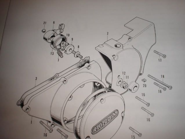

1,921 Posts
i had stuck clutch plates on a bultaco that had sat for some time, i had to pry them apart with a screw driver, took them out cleaned them oiled them and put them back and all was well.
i would check the plates to see if there stuck together, then find and adjust the slack adjuster, not the cable but the [ clutch lifter adjusting screw]
its right under the brass grease nipple,
first you may want to take off the rear cover disassemble the lifter, clean it and grease it, see items 6 through 13 don't lose the ball # 21

Bissinger,
If you don't get any lever and have adjusted tthe cable as best as you can, then the problem is in the adjuster in the left cover that Midge posted. I would suspect that the adjuster is turned so far that the triangular bearing piece Patr #10is out of its ramps, or even more likely, the ball part #21 is not there. The PO probably lost it and didn't notice it was missing after reassembly and sold the bike. This is not a clutch plate sticking situation. When that happens you pull the clutch lever and compress the springs nd the clutch stays engaged. In that case, clutch pull feels normal.
So pull the left cover, Check that part 21 is there. then reassemble and adjust the clutch according to the manual.

sorry about the lack of clarity. there is NO pressure in the clutch lever. Ill take it apart probably on tuesday night, and post some pics. If I recall correctly I dont think that little ball is in there. what does it do?
