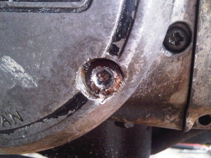

So far i have tried to get this screw on my alternator cover out using and easy-out, a spiral extractor (which snapped off inside where i had drilled), and an impact driver. It is soaked in a lubricant to try and break down whatever is seizing it. Any other thought as to what I can do to break it free, other then to drill it out and retap the hole with a larger screw?
Keep drilling until the head falls right off that screw, and once the cover is removed, you'll be able to unscrew what's left of it by hand.

i did the same to a screw on my oil filter cover, and i used a reverse drill bit to drill it out, and when it just barely cut through the head material it caught and backed it out.

It came out as i was drilling it out with a easy-out. I was just trying to drill the head off with the biggest bit I had and just about when it had drilled off the head, it backed itself out. Any idea, other then the hardware store, where I can pick up SS hex bolts to replace them with?
