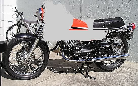

Awhile back a guy posted about making a Cafe Seat cowl out of an old tank. Well, I want to do that on my RD350, but actually carrying it out successfully begs some questions:
1) What to use to clean the inside so thoroughly to ensure there are absolutely no fumes left that can explode from sparks made while cutting it in half; the tank has been in use and has not yet been taken off or drained.
2) What exactly to use to cut it so as to do minimal damage to the paint and graphics. Since its the same color and graphics as the other, I'd like to be able to just touch up where it's cut and not have to blast and repaint, if it's possible.
Any ideas to facilitate this would be appreciated!

Here's my plan of attack:
1) Clean out, dry tank
2) Mark on the current seat how far I want it to go back before becoming in contact with the cowl. Mark the pan with a slight indent cut which will survive media blasting.
3) Strip off foam, have it blasted and powder coated.
4) Cut the cowl and rivet it onto the back of the pan. I cannot yet, and do not yet have a welder, so that's out. I saw other posts in which people said it works fine. I'll probably epoxy a very thin neoprene layer in between both pieces with holes allowed for the rivets, since the RD350 is a fairly buzzy bike.
I planned on allowing at least 1/2" overlap in front length to have something to work with, perhaps keep the piece on top as a base to attach a very small, long, narrow hinge for the cover. I'm still working on ideas and thoughts for the cowl front cover.
I have a (cheap) air angle grinder with a cutoff wheel. What type of wheel or device are you using, teighlor? I'd love to see pics. I even wondered if it would be too difficult, too much work to try using a hacksaw so as t minimize paint damage. Am I way off base here?
In more thoughts and ideas would be greatly appreciated, as would pictures, too!
