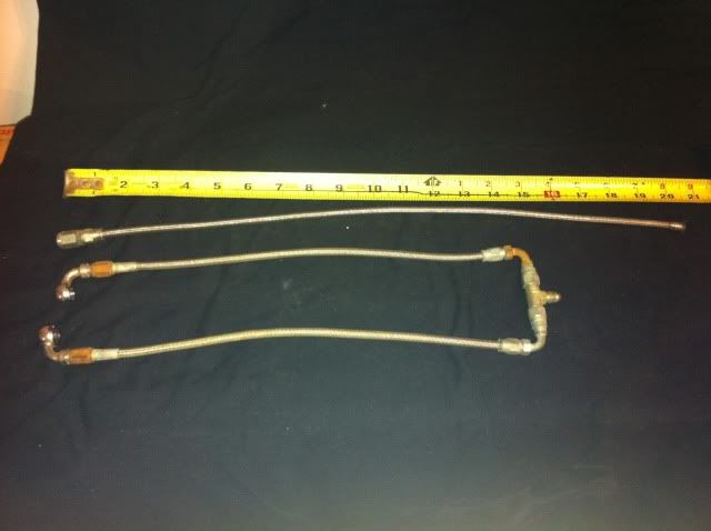

I need a setup pictured below but as one piece. I will put my own removable fitting on the open end because it has to thread through the center hole of the top triple tree nut before ending at the m/c. Can you do them in color or just the black pictured? I would like them blue if possible.
How complicated is that set-up? Why dont you just run 2 single lines straight from the MC to each caliper? Or a single line to one caliper, then a loop over the guard to the other caliper?. Would probably be cheaper without all those connector fittings, too.

Yeah, that is a bit complicated and looks pretty gross too. Why don't you call me at 804-505-0006. I'm not sure what bike this is even for but if its for a sportster and you are using the factory trees, I have something that bolts on for a splitter. If something else, we can run two hoses or one jumper like Hillsy mentioned. I can also get some unions like this:

Or you could use any number of oe splitters like this CB750F splitter that holds two 10mm banjos on one side and one on the other. Lots of better options i think. I can do blue hoses as well.

The rule of thumb with brake lines (and hydraulics in general) is to keep it as simple as possible with the least amount of joins that you can. Connectors / splitters / joins can trap air bubbles and bleeding the system can then become a nightmare. Not to mention the increased chance of leaks with a bunch of joins like that.
