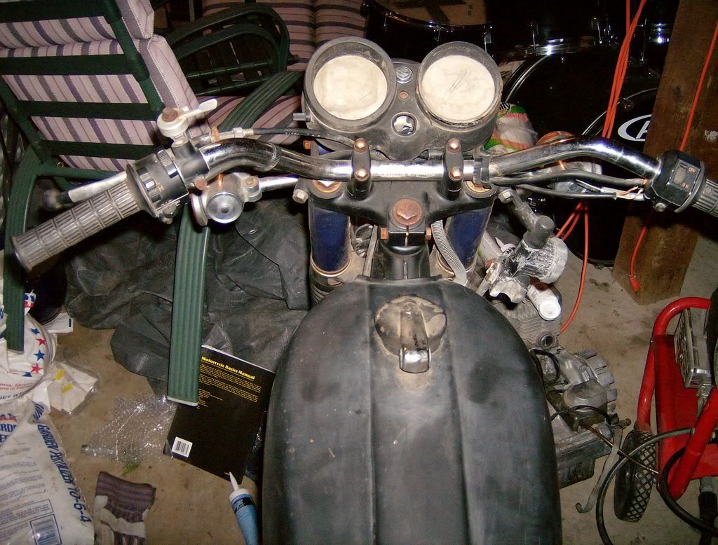

Wats going on everyone? I am new to motorcycle restoration, and conversion for that matter. Due to the college life my funds are rather limited, therefore i have become content with focusing on cheaper vintage japanese models. I recently acquired an old Suzuki gt550 along with a manual, 3 extra carbs, and another gt550 engine that im not sure works for about 200 bucks. Can this be a good cafe racer project? and if so I need to know where to start on this bike, as well as the chronological order in which i should go about converting this bike into a nice racer. Here's samples of what im up against!!

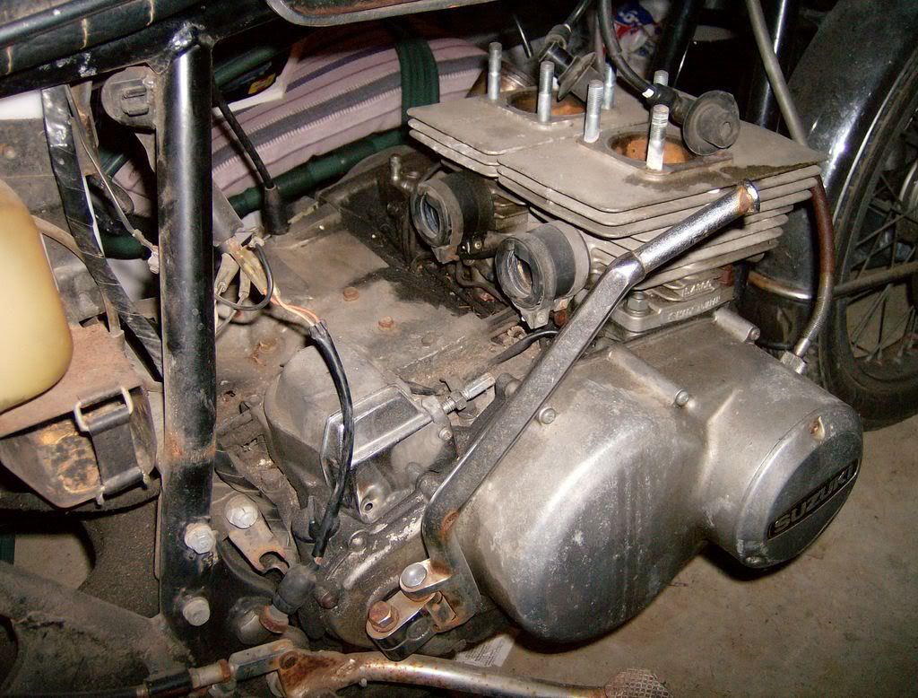

Capitol A, Welcome to the forum dude. The good news; nice bike, and it could be a cool cafe. The bad news; since you're starting with something that old, and partially torn down, you're probably going to have to complete the engine teardown/rebuild, and by the looks of things, go through the entire bike. Stuff like tires, wheels, wheel bearings, wiring/electrical/gauges, as well as gas tank, seat/bodywork, controls, chain, etc.
In short, it's a full project. I don't want to discourage you from doing it, you've got the manual, which is great.
I'd start with the engine, determine the condition of the cylinders and pistons, and see if you can get away with just freshening up the top end...you may get lucky there. As far as order after that, it's up to you and your budget, but I'd look at everything, see what you can use and what needs to be replaced. Pay close attention to wheels/bearings/brakes. Assume you'll be replacing wheel bearings, tires, chain and sprockets, battery, air filters, fork seals, brake pads.

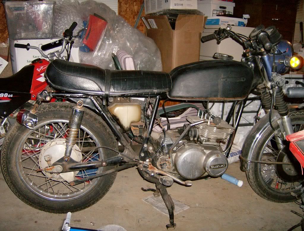

Kid...you broke the cardnal rule about beginners and motor bikes...you bought a bike (turd...whatever) in the worst condition for a beginner possible. I hope you don't have any delusions about riding the thing this year. There is so much important stuff missing too that I can only guess you bought someone else's parts bike (seriously: the carbs, the heads, parts of the wiring harness - you need these things!!!) The only consolation is I hope it was free or close too. If you are new to this, always buy the best bike possible for the money. These are old bikes anyway so there will always be stuff to fix. Get us some pics of any spare parts you got with it - but my best advice is to part it out on ebay, take the money you make from it, and buy something that is at the very least complete. This is the wrong project for a beginner.
That being said GT550s are awsome bikes, I really like them. I have seen some nice running GT550s sell for a couple o' hundred bucks (ratty looking but running) so if you want to stick with this kind of bike then it should not be hard to find a running one cheap. Of all the two stroke bikes out there suzuiks are the better ones for beginners.

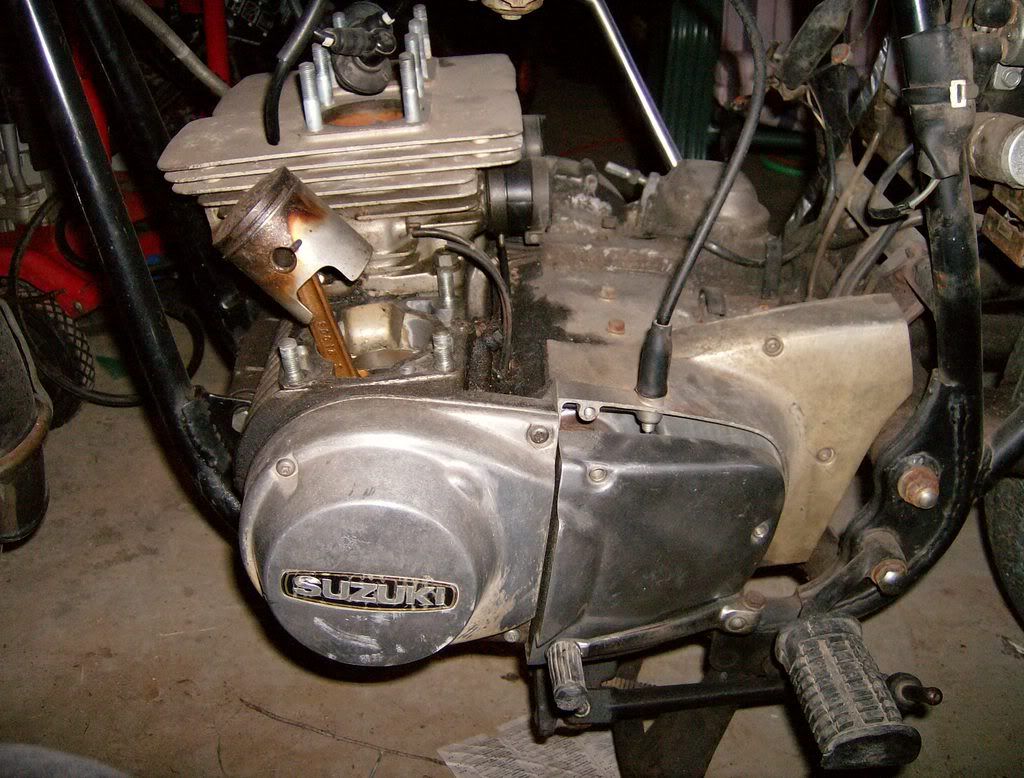

It is a two stroke so start with the motor. Does the one in the frame turn over? (do the pistons move when you kick start it?) Does the spare motor? The first thing to go on these and the most expensive is the crank seals, but before you worry about them see if you even have a good bottom end. Either way you are going to need the crank rebuilt but the difference is whether you need bottom end bearings also. If you have a motor that turns over you are going to need to seal it up (I don't see this happening on the one in the bike, but maybe the spare engine) and leak down test the crank seals (move the piston to the bottom of the travel and pump 5 psi into the engine through the spark plug hole and see how slow or fast it leaks out - fast and the seals are shot). If you need a crank it will probably cost in the neighborhood of $300 to rebuild not counting shipping and parts. Send that off an turn your attention to the frame.

What Geeto says is true - with what you've got your odds aren't good. What you've got there isn't a motorcycle - it just sort of looks like one - and turning it into one is going to be frustrating and expensive. I'm not suggesting you get one that's perfectly square and already cafe'd - where's the fun in that? - but I'd part out, get your money back and probably a bit to spare, and find a complete bike.
